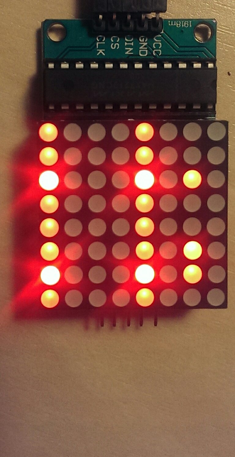

Hello Arduino folks!
I've got an 8x8 led matrix with a MAX7219 controller from china. I thought it would be easy to get it working but I was wrong. I did the following steps but all I get is all leds lighting up no matter what I do.
  1. Downloaded LedControl library and installed it to my Arduino IDE.
  2. Connected my arduino to my LED matrix and its MAX7219 in the following way.
    Arduino pin 12 is connected to the Din
    Arduino pin 11 is connected to the CLK
    Arduino pin 10 is connected to CS
  3. Open up LCDemoMatrix example sketch which looks like this

Notice that they say that these connections probably wont work? what do they mean?
4. Code uploads without problem but all Leds light upp and nothing else.
I've tried all libraries and examples I could find, what should I do?
thanks alot!
How it it wired up, you only told us a bit about the wiring.
Where is the 5V coming from and have you got a common ground with the Arduino?
Heres the setup.
Check this topic - I think you will find it relevant.
Progress! I plugged out the led matrix and rotated it 180 degrees and plugged it back in. Now I get some action on the screen.
When using the ledcontrol library and writing
lc.setLed(0,3,3,true)
To set display number zeros pixel at column 3 row 3 high it shows that(the two lines are high whatever I seem to do.):
Anyone got any idea? Would really appreciate it :slight_smile: thanks guys!
Archelon:
You didn't explain what you did or did not get at that point.
Oh! Here is another picture, is it?
Photo is marginally better than before.
Seems to confirm the relevance of the link I posted above.
