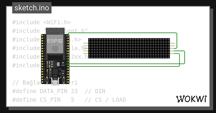

I tested your code in the simulator and it looked the same as your display, so I changed the HARDWARE line and it worked correctly.
See simulator:

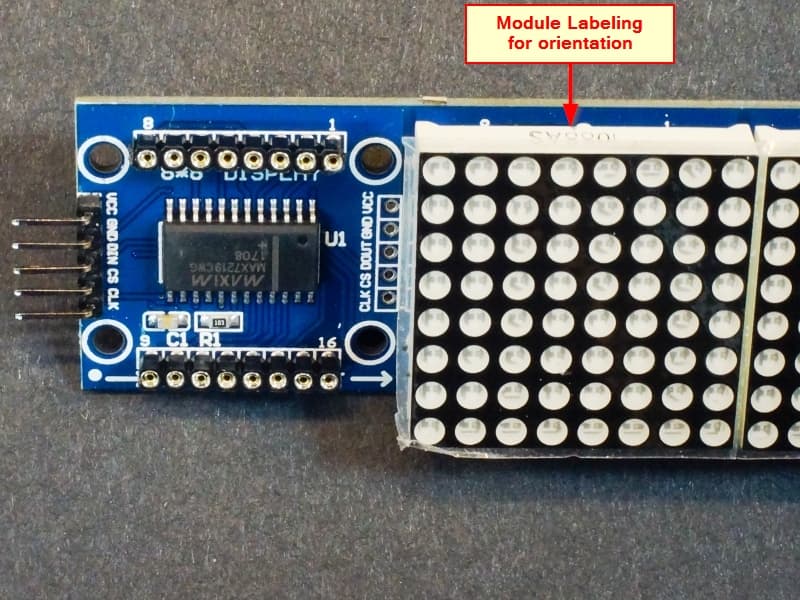

Does the white part LED matrix have a direction?
I soldered them all in the same direction.
Could I should soldered them in the opposite direction?
I am not sure the direction.
@ruilviana
Ref: MAX7219 8x8 Dot Matrix (x4) Red Display Module - ProtoSupplies
I had a 50% chance. I soldered it wrong. :frowning:
I didn't know matrix had a direction.
I have to remove 64 solders and re-solder them.
I will try tomorrow and inform here. Thank you dude. @ruilviana

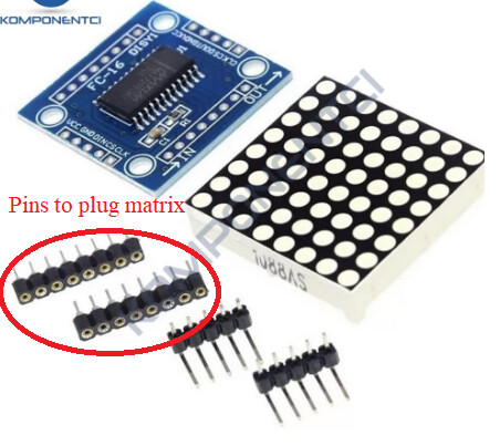

a7
Did you solder the matrix directly to the PCB?
Didn't you use the pins that came with the kit?
If you used the pins, simply pull the die to remove and invert.
It looks like this library might help. " [MD_MAX72xx] "
I'll try the example: " [MD_MAX72xx_HW_Mapper.ino]"
  • HW_DIG_ROWS – set to 1 if MAX72xx digits are mapped to rows in the matrix
  • HW_REV_COLS – set to 0 for normal orientation with col 0 on the right, set to 1 if reversed
  • HW_REV_ROWS – set to 0 for normal orientation with row 0 at the top set to 1 if reversed
See if any of these settings resolve your issue:

See in the simulator, it was inverted with my HW.

@ruilviana Hello Dude,
I just tried your advice and my problem is solved. I really thank you.
I have never heard Wokwi, It's looks really good platform. I will use this website, I also thank you for this.
I've complete my clock project thanks to you.
