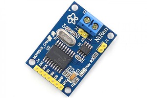

I am attempting to use an MCP2515 module and an Arduino Uno to read data from the OBD-II port on my car. I have tried multiple different CAN libraries for Arduino but can't seem to get it working. I have the MCP2515 module connected to the Arduino following the same setup as on this website.
CS to pin 10 (or 9 for some libraries' examples)
SO to pin 12
SI to pin 11
SCK to pin 13
Here's an image of the one I'm using from google images (I know some people don't like to click links):
Here is a link to the exact module I bought (Came with an OBD-II cable): MALE OBDII OBD2 Adapter Cable + SN65HVD230 CJMCU-230 CAN Bus Transceiver Module | eBay
One thing that was really odd was that the pins on the cable I got from that ebay listing were flipped. Where pin 1 usually is on an obd-II cable, was pin 8, and where pin 8 usually is was pin 1. Same with the bottom side. I found the right wires to use using a continuity tester and connected them to the H and L pins on the MCP module so the connections should be correct now. But I still have the same problem, which is that every "receive" example from the libraries I have doesn't work.
Some of the examples have tests to make sure that the Arduino can communicate successfully with the MCP module, and those tests always come back successful, so I think I have it hooked up correctly to the Arduino. But after those tests pass, it doesn't receive any data from the car.
I'll give one example of code I tried to run. It uploads successfully to the Arduino, but I only get one line of output:
"CAN Receiver." If I have the module connected wrong, I get, "Starting CAN failed!"
