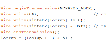

  Wire.beginTransmission(MCP4725_ADDR);
  Wire.write(64);                     // cmd to update the DAC
  Wire.write(sintab2[lookup] >> 4);        // the 8 most significant bits...
  Wire.write((sintab2[lookup] & 15) << 4); // the 4 least significant bits...
  Wire.endTransmission();
  lookup = (lookup + 1) & 511;

You need to rightshift 8 times, not 4 times. Remember that 1 byte is 8 bits, not 4 bits. Adjust the mask to oxff (255) insteaf of 15, and don't do any shift. You can likely drop the mask as well if the low byte is sent in the write.

Yes. You are wrong: the frequency of the waveform, according to my scope, is around 25Hz. You're not going to see that properly with a DVM. What you describe, however, is exactly what I'd expect.
Try removing this line
and telling us what you see.
[edit]
OK. Instead of removing that line, add
delay(1500);
right after it. Now you should have a very slow sine wave that the DVM can track.
