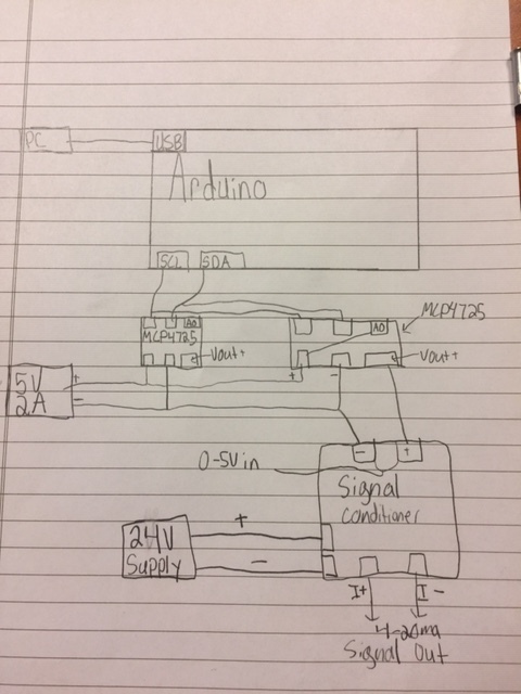

I have two MCP4725 DACs connected on the I2C bus. I connected them as the data sheet says and all was great and dandy, and even ran a triangle wave example and viewed it on an oscope.
It was working for a few hours and outputting the voltages correctly but then I connected the vout and gnd of the second DAC to a signal conditioner that takes in a 0-5V signal. The DACs stopped working. Once I realized it wasn't working, I reverted everything back, meaning I just disconnected vout and gnd from the conditioner and measured the output which is now stuck at roughly 2.5V. Same code and wiring which was working before. And even though I only wired one DAC to the conditioner BOTH now do not output different voltages just stuck at around a constant 2.5V .
My thinking is that the signal conditioner might have drawn too much current from the DAC perhaps breaking it but it doesn't add up as to why both would now not be working even though only 1 was wired to the signal conditioner. On top of that, the signal conditioner runs on a separate 24v supply, so it probably isn't pulling much current if any(will double check with a meter next week). Heres a link to that signal conditioner i keep mentioning. https://www.automationdirect.com/adc/shopping/catalog/process_control_-a-_measurement/signal_conditioners/dc_voltage,_current_or_potentiometer_input/fc-33?gclid=CLb48riQ1uICFQ7bwAodlkMEQQ
Here is my wiring diagram

Can you draw a circuit diagram of your complete project, including the conditioners and how they are powered please?
Just a picture of a hand drawn circuit will speak volumes.

Rough hand drawn photo of my circuit.

Hi Tom, Uploaded a rough photo! Thanks in advance !

Ether your schematic is missing important connections or:
There is no common connection (0V, GND) shown between the DAC's and the Arduino. That will not work.
The 5V 2A supply as shown is totally unnecessary, the DAC boards can be powered by 5V output of the Arduino.
The signal conditioner is galvanically isolated so no issues there between the Arduino & DAC's and whatever is being controlled.

The schematic is rough but it is how I wired it. I did not know the DAC must share a common with the arduino and will make sure to do that. That being said, though why would that cause an issue especially after it ran for hours fine? Thanks, Alex.
