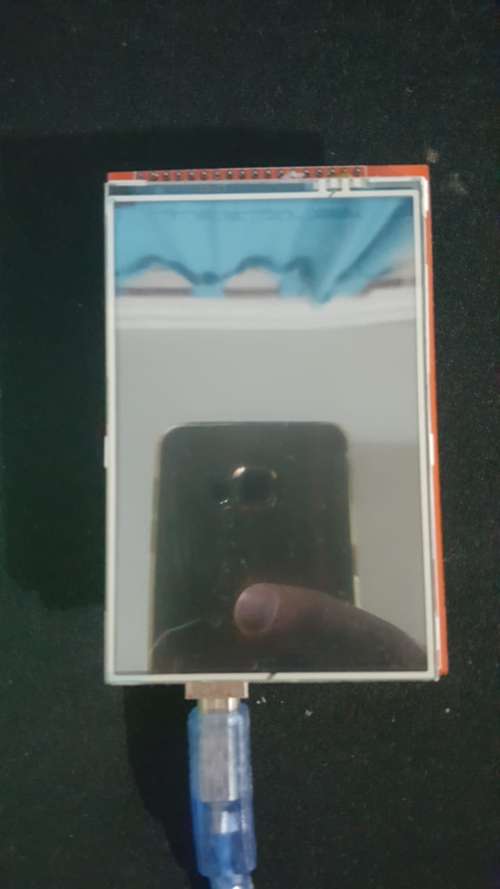

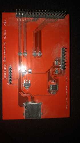

Here I took pictures ...

It is only the pcb photo that I need.
You have a Mega Shield with 8-bit parallel data bus, XPT2046 Touch Controller, microSD card.
TFT: define USE_SPECIAL, USE_MEGA_8BIT_SHIELD
Touch: use URTouch.h library
SD card: SD_CS=53. Use regular <SD.h> library. (It might be unreliable because the Resistor Pack has a high value)
It is not possible to read the controller ID.
If it has an ILI9488 controller (0x9488) graphictest_kbv should work 100% except for ID and SOFTWARE SCROLL.

Your shield has a XPT2046 Touch Controller on pins 2-6.
