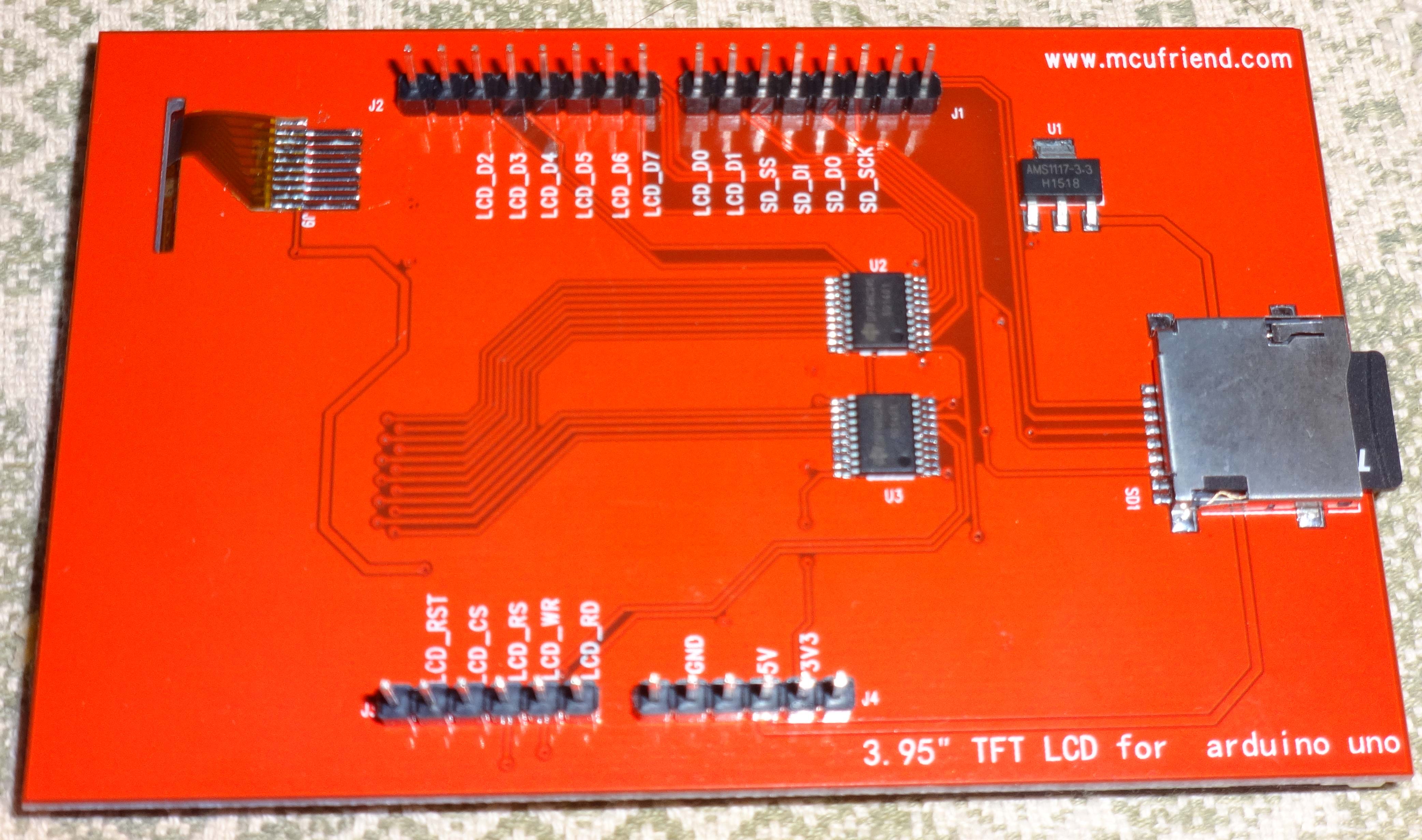

Please tell me if there any function to enable / disable (on/off) the screen? Ready to listen to any advice and recommendations! I have 3.95 mcufriend shield... Thanks!

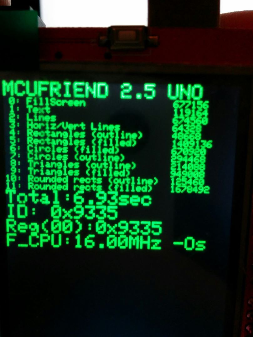

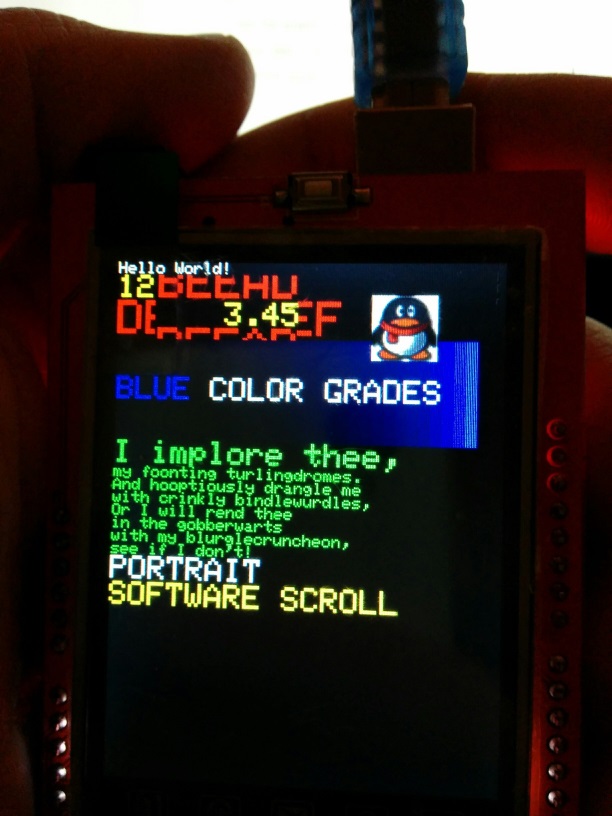

I ran the graphictest_kbv and it seems to work fine on my ili9335. The benchmark runs in 6.93 seconds (see attached picture).
As you said, "color band scroll" doesn't work.
"Software scroll" scrolls only a rectangle under "Hello world" (again, see picture). Is this normal? If yes, mark it "tested"!
Thanks for your report. Yes, both JPEGs look correct. I will update the "tested" list.
The reason for this odd window for "software scroll" is for compatibility. ( if the sketch is running on tiny 128x128 displays with different library)
If you change the #if in the sketch, you can use a more intuitive demo of the scroll.
But it is out of view on a small screen.
No, I do not have a method for sending the controller to sleep or on/off.
It is easy to do with "modern" controllers like the ILI9488. It will make little difference to the power consumption.
Most current goes to the backlight. There is no way to turn this off without hacking the shield.
You would need to switch the 5V pin.
Most of these shields use the 5V pin from the Arduino to supply the backlight.
They use the 3.3V pin from the Arduino for the controller logic.
Cut the trace between 5V pin and the shield LDO regulator.
Place a 500mA PNP transistor between 5V and LDO.
Control the transistor with the (unused) A5 pin via a resistor to the base.
UNTESTED. Do any mods at your own risk. The backlights take 100mA - 200mA.
David.

david_prentice:
I thought exactly the same, but I'm not versed in microelectronics.
david_prentice:
You can look at the attached photo, and tell how and what to do in my case?
I connect this shield to mega2560 with the wires, so I can insert an additional circuit with a transistor before 5V connection.
Which of the inexpensive transistor can you advise?
david_prentice:
I completely understand. Thank you very much for your help!
Any PNP transistor with a max collector current of 500mA or so will be fine.
I looked at what transistors I have. I seem to have several BC212L that are probably 30 yrs old.
Looking up the data. It is 300mA max. With a min hFE of 50. i.e. 4mA base current for 200mA.
So a 1k0 base resistor would switch it on.
If you are buying a new transistor, look for a 500mA PNP with hFE > 100. Look for a plastic case like TO92.
You can see the pcb trace that goes from 5V pin to U1. It looks easy to cut.
You can get at A5 pin by soldering on to the top of the header pin.
Glue the transistor and base resistor to the pcb with some epoxy.
Connect up by soldering some fine wire from A5 to the base resistor.
If you do not understand this, you should not attempt the mod.
I have not tried it.
David.
