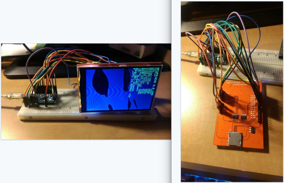

one3rdnerd:
  1. I believe so, at least for non TFT screen related stuff.
  2. I haven't, what would I use to do this? I was using USB power. I have a power adapter also but its at a friends.
  3. When turning on it a kind of blue screen once turned on. When I load sketches like the graphicstest sometimes I get a flicker and that's it, one time I got coloured lines repeat for a while then back to original blue screen and the one time I managed to get the graphicstest to run in full.
Yes I am using 2.9.1-beta in IDE version 1.6.10
Thanks David :slight_smile:
David
I suspect that you have a bad connection somewhere if sketches worked in the past. i.e. examine pcb with magnifying glass.

Hello, first of all i want to sat that everything works in my case :slight_smile: (thank you for this awesome libray david_pentice!! good job) but Im wondering how A5 pin works.
Im using tft lcd 0x9481 (it is broken but it is prototype for now) and arduino nano connected as you see by wires. It is because i want to use RTC on I2C that usesA4(SDA) and A5(SCL). Im not using Sdcard or touch. A5 pin is free but A4 is used for lcd reset. When i disconnect this wire lcd goes white. Only way to get it back to working is to connect it to +5V as you advised earlier in this thread.
But im wondering if A4 pin is ready to use for I2C communication or I have to reconfigure it somewhere ? When I connect lcd reset wire to D12, D11, D10 pin wich is unused lcd does not work. How different is A4 from D12 ? I think it must be software configured somewhere. In your code I found something like int RST=A4 or #define RESET_OUTPUT PIN_OUTPUT(RESET_PORT, RESET_PIN) but i cannot find where RESET_PIN is defined.
Could you explain me how this mysterious A4 pin works ?
Snip off the LCD_RESET pin (A4) from the shield header.
Solder a 10k resistor from the top of the snipped shield header pin to the top of the 5V shield header pin.
The display should work just fine with "Software Reset" (0x01) command. You do not need to make any changes to sketches.
Plug the shield into a Uno or Mega.
Connect your I2C devices to the SDA, SCL pins.
I do not recommend using a Nano. What is the point of buying a shield if you do not use its male-female connectability?
Obviously you can just connect LCD_RESET pin to 5V via a 10k resistor without snipping a pin. But the snip and solder method makes your shield good for any proper Arduino.
Do you have a Red or Blue shield? The blue shields sometimes overheat. I am not sure why.
David.
Thank you for reply ! I attached picture. I have red board, and this violet cable is for lcd reset. But after some time bottom of lcd gets hot. Should i use 3V3 or 5V for lcd ?
So you suggest using tft on breakout board for arduino nano ? This is my first tft so i searched ebay for tft for arduino uno. I thought by doing this I will be sure that it works with my nano. Also i decided to connect some more things to arduino and using it as a shield would use all the free pins. But using it with uno and snipping off lcd reset pin is also a good idea :slight_smile:
But anyway, ok i tried with 10k resistor yesterday and it works. Ahh, software reset with 0x01. So lcd reset wire just needs pull up restor for working (to have precise logic state)? A4 pin is working with lcd and D12 is not because of internal pull up resistor or in/out software configuration?
I do not have to make changes for sketches even though i found this #define RESET_IDLE PIN_HIGH(RESET_PORT, RESET_PIN) ? Why is it defined and used although software reset is used ?
You should connect every pin from the shield to the corresponding pin on your Nano. i.e. if the shield says 3V3 you connect it to the Nano's 3V3 pin. Likewise the 5V shield pin to the Nano's shield pin.
Why?
Uno clones are so cheap. A shield is always going to mate correctly. You always get good electrical connections.
I use Software Reset for the modern MIPI controllers. Old controllers like ILI9320 do not have Software Reset command. They all get the Hardware Reset. You do not need to change any library software.
You probably need to call Wire.begin() after tft.begin(). Try it for yourself. Then swap the order and see if it upsets TWI.
Oh, some new Uno clones come with SMD AVR and extra holes for header pins. And access to A6, A7 and extra headers for I2C
