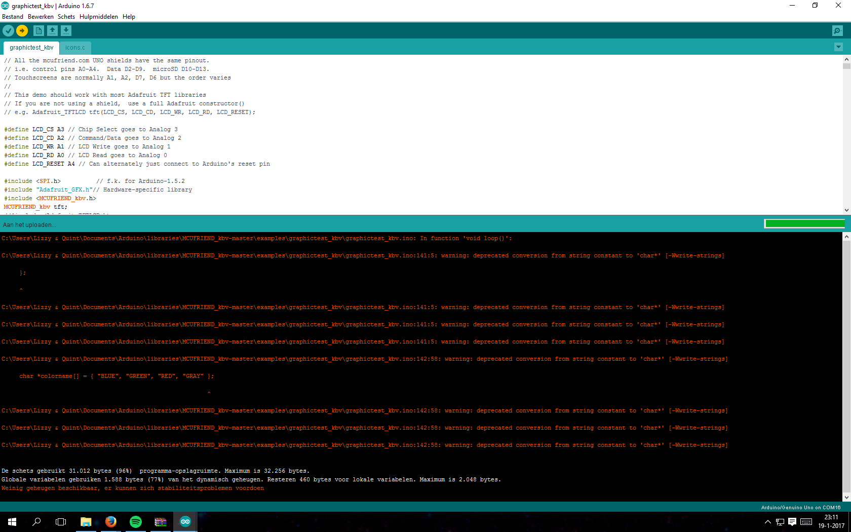

Hi David, adding "#define SUPPORT_8347D" did do the trick, to get the screen working. But i got some warnings. Just wondering how to fix these? Thank you.
kind regards,
Quinten

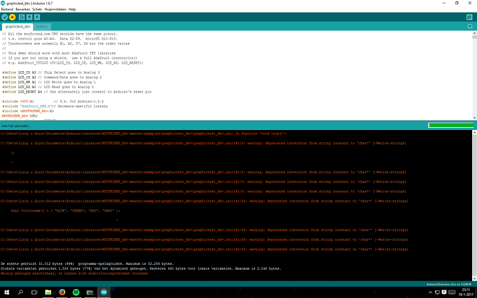

The warnings are simply about anonymous string constants. You don't need to worry about them.
You can avoid most of them by adding the const keyword. e.g.
    const char *aspectname[] = {
I intend to tidy up the graphictest_kbv sketch. If I can make it smaller, I can have more "SUPPORT_XXXX" models that work out of the box. Obviously it is important for the examples to run on a Uno. Better if the warnings disappear.
I doubt if I would ever enable the HX8347, HX8352, SSD1289 by default. But it would be nice if ILI9326, SPFD5420 worked by default.

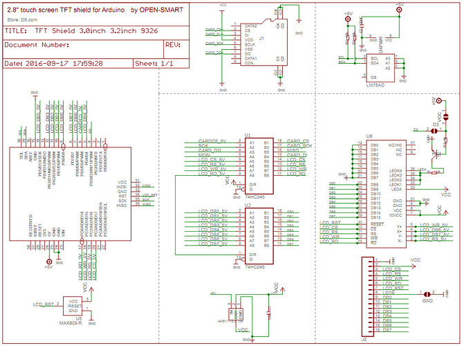

david_prentice:
Your JPEG shows
#define LCD_RST A4    //n.c.
#define LCD_CS A3
#define LCD_RS A2
#define LCD_WR A1
#define LCD_RD A0
#define LCD_D0 8
#define LCD_D1 9
#define LCD_D2 10
#define LCD_D3 11
#define LCD_D4 4
#define LCD_D5 13
#define LCD_D6 6
#define LCD_D7 7
If you would care to run LCD_ID_readreg with the correct defines, I am sure that it would report sensible values. (Remove the microSD from the card holder first)
When you have posted the result, I will look at your "SPECIAL"
David.
