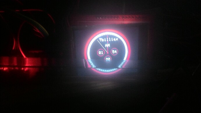

its not the same clock but it is pretty ... i spent a few hours getting it to work with the mcufriend library and instead of millis it uses a ds1302 rtc. i really just hacked that in there because whenever i remove the millis loop weird things happen.. wither way its a pretty clock now i need to add the touch screen part to make it have a dialog to set the rtc. its only related in the fact that it uses mcufriend_kbv and well i like to share code, if it was cleaned up a bit it would be a good example to add to the library maybe in case anyone wanted a quick easy analog clock.. :slight_smile:
Analog_320x240.ino (9.05 KB)
Incidentally, I just took one of Bodmer's example sketches from his TFT_ILI9341 library.
And changed two lines in TFT_Clock.ino:
//.kbv #include <TFT_ILI9341.h> // Hardware-specific library
#include <TFT_HX8357GLUE.h> //.kbv GLUE TFT_xxxx library methods to MCUFRIEND_kbv
TFT_HX8357GLUE tft;        //.kbv constructor finds and uses correct controller
#include <SPI.h>
#define TFT_GREY 0x5AEB
//.kbv TFT_ILI9341 tft = TFT_ILI9341();       // Invoke custom library
I think that his illustrates just how easy it is to port / adapt sketches that use Adafruit_GFX style class methods.
I do not have tbillion's DS1302RTC library. So I could not build his sketch.
However I did note:
tft.begin(0x9325); //perlu address ini saat menggunakan lib.SPFD5408_Adafruit_TFTLCD.h
It is wiser to use:
  tft.begin(tft.readID()); //.kbv make sure that you use the actual controller on your Shield
