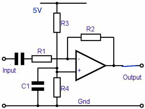

First step - pulse conditioner = convert 1.2V pulses to 5V rectangle pulses then try to use frequency meter program.
R1 = 1k, R3, R4 10k, R2 1M.

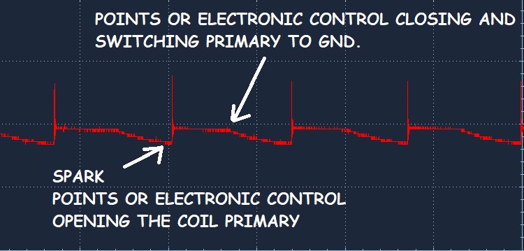

This is what i'm measuring with a highpass-filter.
I believe that you are monitoring the ignition noise.
30ms = 1000rpm.
5ms = 6000rpm.
However the noise you measure may not be there when it comes to regular driving as load on the engine will have an effect on the spark energy and hence the magnitude of the cyclic noise that you see.
What happens when you turn on headlights full beam, heater fan, indicators?
Even applying the brake and making the brake lights come on.
The load on the electrical system will have an effect on the noise that you see on the 12V supply.
Worth checking before you make any hardware decisions.

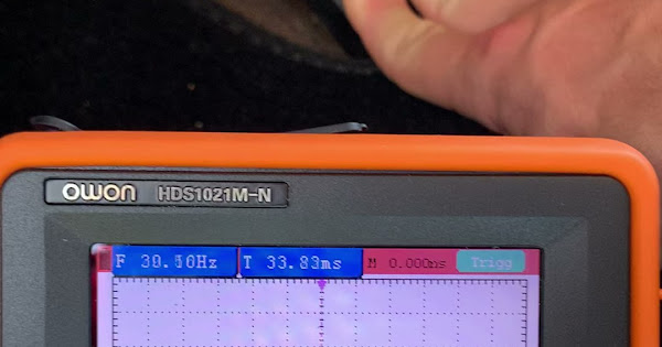

Upper Picture is 1V per square in Y and 10ms in X per square
The other one 1 per square in Y and 200 mys in X square
Checked this, still aware while driving
Here you see a video how the oscilloscope looks like while revving the car:
