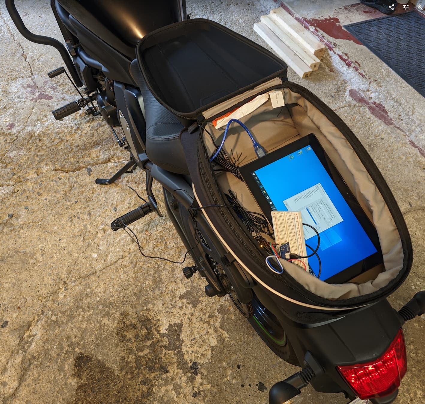

I logged the data from two JSN-SR04T (ultrasonic sensors, look exactly like those in car bumpers) sensors ziptied to passenger's foot pegs.
Here are the graphs of the readings:
The only "filter" used here is that I don't log data if any sensor reads 0 (as it sometimes does that for some reason). Unfortunately I don't have any data from gyro/accel anymore to show and compare but nothing was that nice and that says something. There's no drift! (well duh, since I'm measuring distance to the road surface)

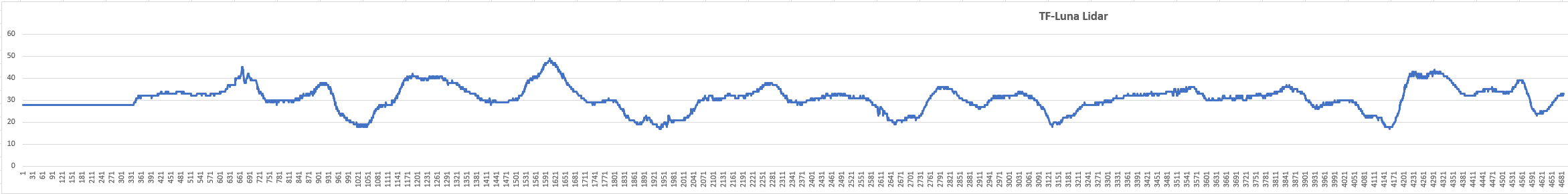

I also got MakerFocus Lidar, the so called "TF-Luna" Amazon link and library taken from budryerson github. There is no filtering of any kind here. Just raw data from the sensor:
I must say that Lidar looks very promising. I ordered second sensor as I need two in order to differentiate between bike leaning and bike height changing due to potholes (or me having too much for lunch). When I get the second Lidar and get around to working on this project I'll post another update.
Edit: oh boy it has been 12 days already? Lidar graph, around 661 mark, is most likely me driving off from the driveway onto the road. Shows that I must have two sensors and take difference between them to calculate the lean.
