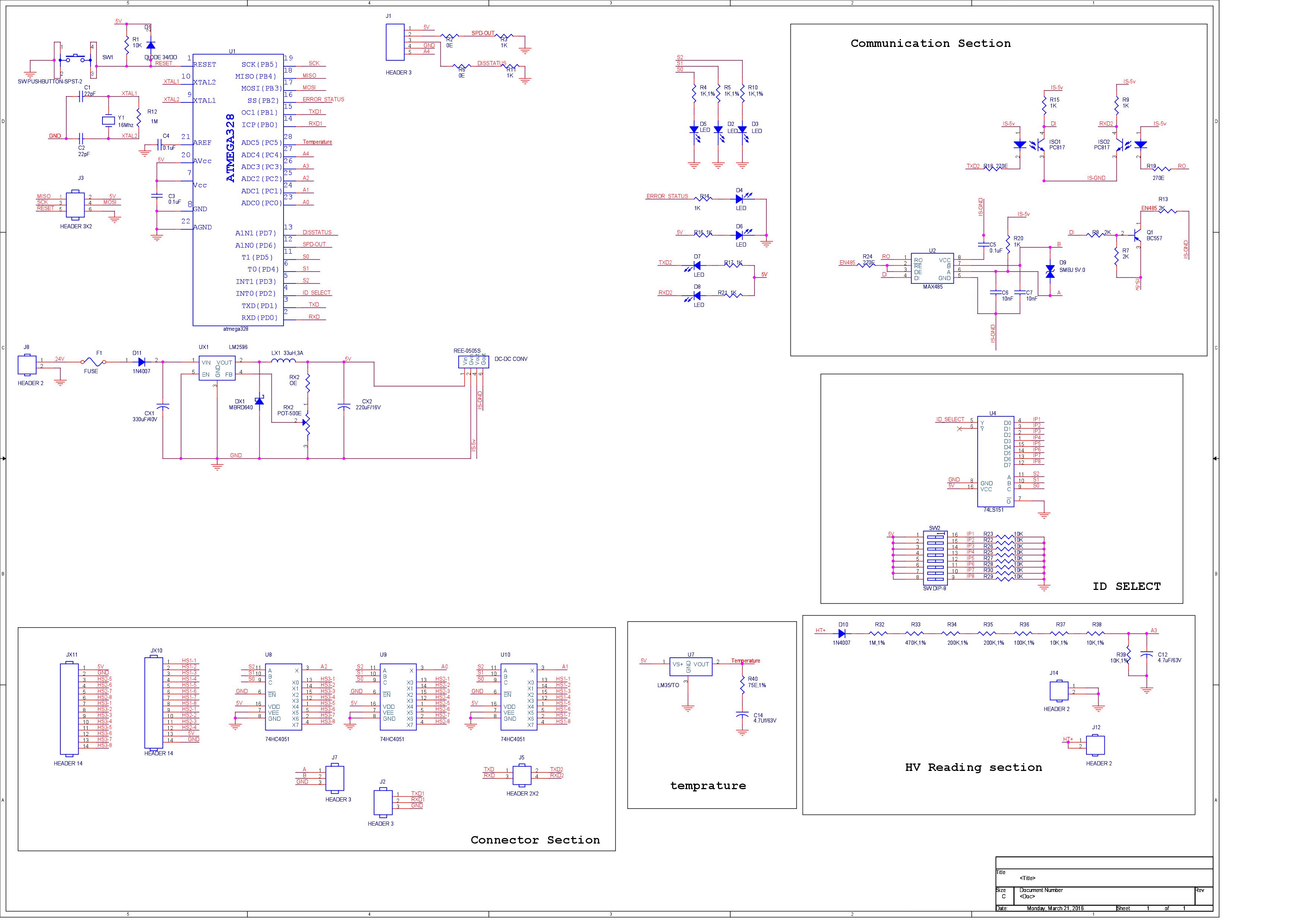

Here i am attaching old and new schematic for reference.While designing the old board i have made mistake keeping HV- (j14) as common ground reference .
J14 and j12 are connected with high voltage 0-700V dc. Using voltage devider network i am dropping to 0-5v output and feeding analog A3 pin.
I am taking connection of A&B from (J7 connector ) and connected to A & B of the communication SPD**(data sheet attached)** . and earth of communication connected to ground/earth terminal.
Problem statement:
with communication ground connected , When i measure voltage across the j12 . found voltage around 700V.
with communication ground removed,When i measure voltage across the j12 . found voltage around 5V.also when i removed HV+ & HV- wire it operated normally.
So when i tested out i found due to common ground sharing i found 700V .
My question is
How can i separate J12,J14 , i.e HV - ground seprate.
Method1:
Use Voltage transducer ; LM20-P or RTVSM10/25A.I have made setup like this as shown in Capture.
input voltage 260V DC r1=20Kohm and Rm=150ohm supply voltage + or -15v
With this setup. I am getting smoke at input HVside. Can someone suggest what mistake i have done
Method2:
Refer New schematic, I found when voltage measured across A,B w.r.t HV- or earth plate i am getting 700V. So planned to separate the ground for communication side. SO i used isolated 5vDC to 5vDC out put .
When i try with same setup still problem exist.
If i removed communication earth , boards starts working normally. I also replace with communication SPD from other vendor. Issue remains same.
Can someone suggest me How can i measure High resistance , keeping ground isolated.Like HV- (high voltage ground potential)should be separated from Arduino Ground(or controller ground).

My application user for string monitoring . i have totally 24 current sensor which measuring using hall sensor. To measure voltage we are giving 700-800 v from strings of panel.which connected I'm parallel and goes to switch.since its my applixa application how can keep HV ground and low voltage ground separate

Here strings are connected to solar panel. Almost series. The voltage fluctuations depend on radiation of sun.the fluctuations are in range 700-1000v . currently I have given 750v with + or - 5v w.r.t solar panel.
Main intention is to measure the 1000v in range of 5v analog with separate from HV ground and Lv grounds. Kindly reference schematic. Since the ground are same for both. Lower ground or signal ground carry the leakage current or whatever voltage fed to system. In my schematic if remove -ve voltage it operating normally
If we using dpdt relay or spdt relay we are just sepating ground. My intentions are with separating ground I should capable of reading. HV voltage given at input. For example if I m given hv+ 1000v output must be 5v w.r.t low voltage ground . similarly 500v approximately 2.5 v w.r.t low voltage.
In order to measure sensor value. We need to common ground. My question is how can read this value in this case.if it low voltage we could measure directly . since it 700v +1000v DC . how could we measure

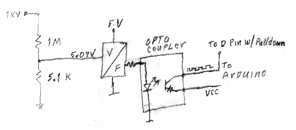

Do you really need a common ground ?
Could you use an opto isolator ?
They are sometimes used in regulated HV supplies.
Could you use a voltage to frequency converter on the high voltage sensor side (expendable of course) and send the frequency signal via opto coupler to Arduino then do a frequency to voltage conversion?

Me either ;D But I've seen the method used in industrial equipment. Here's one link that might help, also google "V to F converter".
ww1.microchip.com/downloads/en/AppNotes/00795a.pdf
Check "Fig. 8".
Something like this:
NOTE: Just an idea, NOT a real circuit.
