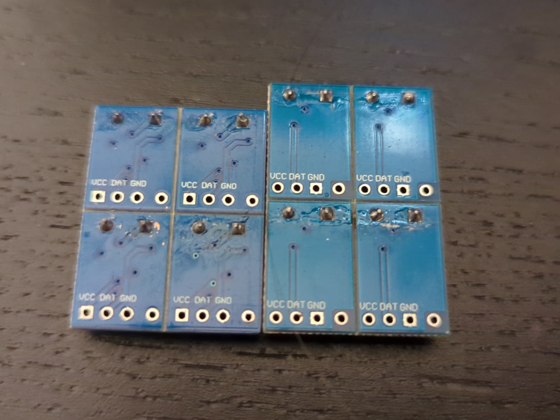

Hey, Ive had this idea on my mind for a while now, to measure the singal strength to determine distance. I have a few 433MHz SYN115 SYN480R RF modules so I can use varying lengths of antenna.
Let me know if this is completely unrealistic.
Here are a few images of the boards because there doesn't seem to be many images online.

A lot of people think this is a simple easy way of measuring distance, but its not.
Any variation in antenna angle, or objects in the path between TX and RX can cause very large variations in signal strength and thus the measured 'distance'.
If you want to experiment, there are quite a few SPI based UHF radio modules (not the ones you pictured) that will allow you to read the received signal strength (RSSI) directly as a digital number and also allow you to vary the power.
Unless you have a way to measure the radiated power from your device and keep it the same as you change antennas, the project is hopeless. Anything different than a 1/4 wave antenna will automatically reduce the radiated power, so you will have to increase the transmitted power to make up for the loss at the antenna.

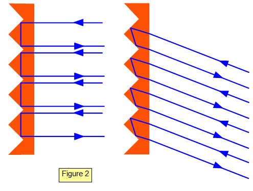

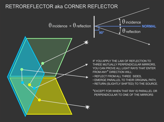

so heres my idea play a tone of 120 Hz pulses in a frequency that cant be heard and measure the delay between spikes and do triangulation. the corners of a room looks really similar to those photo reflectors, wouldn't the corner reflect any sound that isn't in the direct corner? I'd just have to make sure all the mics are synced but I could do that with some GPS modules for time.
