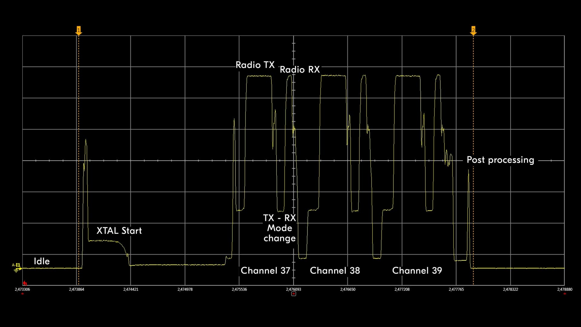

For illustration, consider this picture:
(Source: Power consumption explained)
This is a somewhat typical wireless communication session. Notice how power consumption is anything but stable. Like I said, actual current levels flowing to/from the module depend on capacitive filtering (smoothing out), which makes the situation a little less challenging to measure, but even then you'd need to somewhat accurately measure the total duration of the process in order to get anything remotely useful from it.
You might want to read that link above BTW; honestly I didn't, but it seems to say more or less exactly what I did - but this one is from the experts at Nordic Semiconductor who actually deal with this professionally.

The x-axis represents the GHz, but what does the y-axis represent? The current in mAmps?
No, I interpreted it as milliseconds.
Yes; scale is not provided.
Oh, that makes it a lot easier to work with :slight_smile:
Also much less mysterious :wink:
