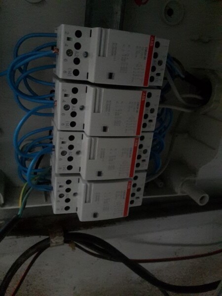

Hi Tom and thank you for the answer, the 230Vac wires and the ABB Contactors are completely seperated. At the moment i cant send some pictures. I think in the afternon i have the possibility to take some picture and send them.
I have also tried to disconnect the motors from the ABB Contactors and test it without motors and there are no problems, so the problem is only if the motors are connected.
Any other Ideas?

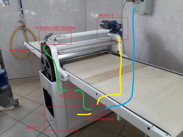

Update
On the first pic I forgot the 3 buttons to controll the system
Now I attached the Overview (see picture, Blue line is the input power) of the machine, on the left side top in middel is the Arduino with the control panel (see picture), to the other side is one motor.
The ralay board is for testing not fixed inside of the machine, it is on the ground savely in an plastic container whith is about 50 cm away from the ABB contactors.
I hope this help

Standard Arduino relay boards are not rated for 3-phase power (which is 415Vac between phases).
Its not clear if your relays are controlling the contactors or switching the phases?
If the latter note that standard relay contacts will burn out on an induction motor load without
appropriate snubber circuit, and you are exceeding the design voltage of the relay board.
Your crashes and problems may be curable by using the relay board fully opto-isolated (many relay
boards support this if you provide separate power to the relay board), but first checkout the
basic safety issue of employing single-phase equipment on a 3-phase circuit...
The arduino relays are only switching 230V to the contactor coils of the 400V motors.
Tom.. :slight_smile:
Exactly the Arduino Relay are only switching 230V to the contactor.
Can I maybe resolve the problem using an opto isolated board?
I have read on the page for the relay board and i found find out that this board use 4 optocoupler
https://www.sunfounder.com/wiki/index.php?title=4_Channel_5V_Relay_Module
Any other ideas?
