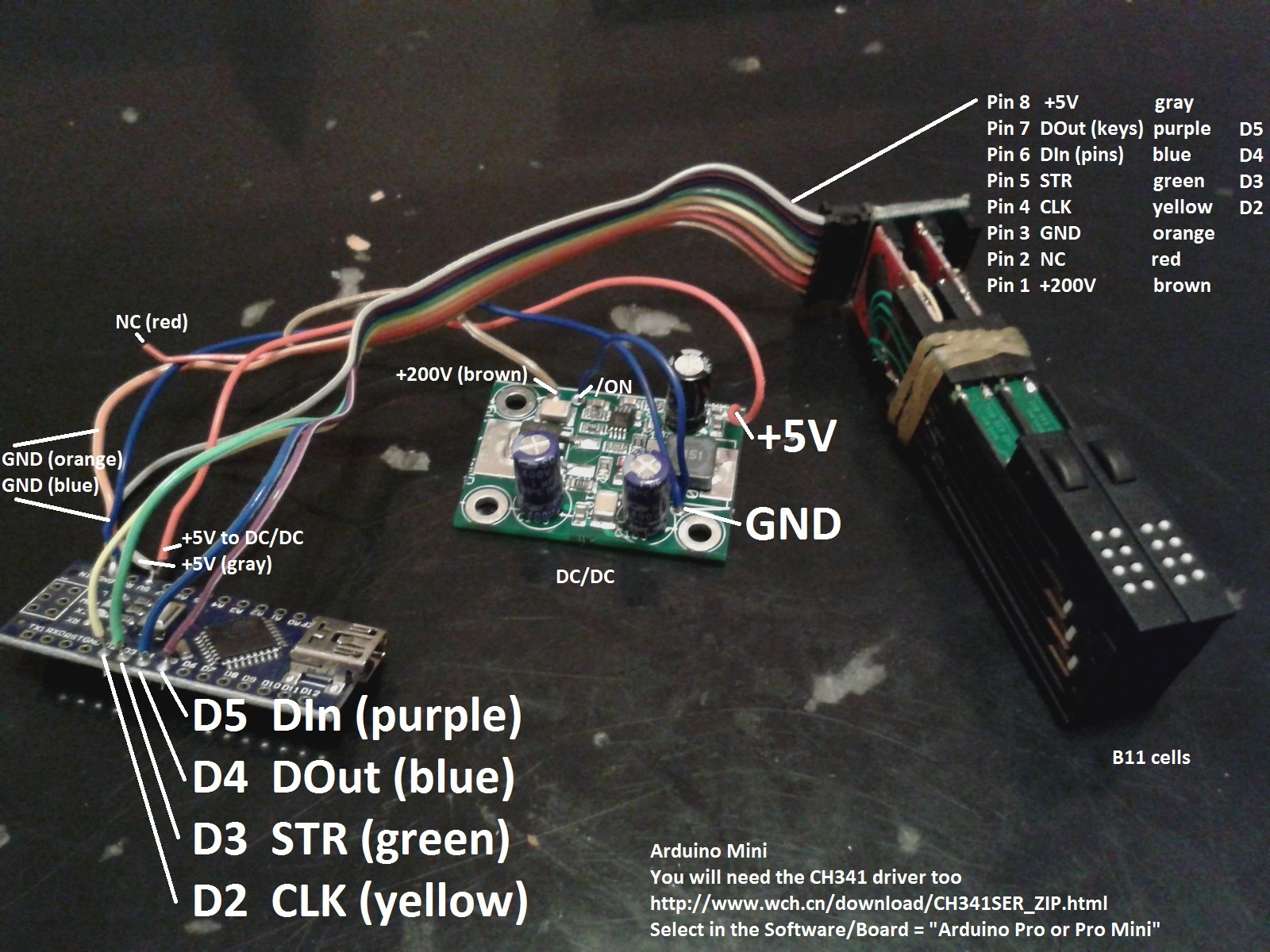

After a bit of tinkering (we're far from experts), we were able to connect the braille cells, a DC2DC converter to feed them, and an Arduino Uno. Adjusted the sample code (http://web.metec-ag.de/B11B12%20Elektronik-1.pdf) a wee bit for it to run on the Arduino, and we're at present capable of controlling each individual pin.
Which is nice!
Below you can find the sample code and, in attach, a first attempt at Fritzing to show how everything is connected.
What we're interested in at the moment are the following items:
-> Has anyone else been using these or similar parts? Any experience to share?
-> Are we doing something stupid with the grounding of the DCDC step up converter, the Arduino, and the Braille Cells? (we're not exactly engineers, far from to be honest)
-> Any ideas about casings? Most likely, we'll cover a table in velcro, as well as the bottom of the individual Braille Cells, so we can reposition them as often as required, in whatever constellation (so one finger can be put over multiple cells, or there's one cell per finger, or...). But even so, we'd like them to be placed in individual casings. Their size is about (w,h,d) 6 mm, 17 mm, 74 mm. We've been looking around on vendor sites, but maybe there's a few good ones we're missing.
-> Any feedback is more than welcome!
