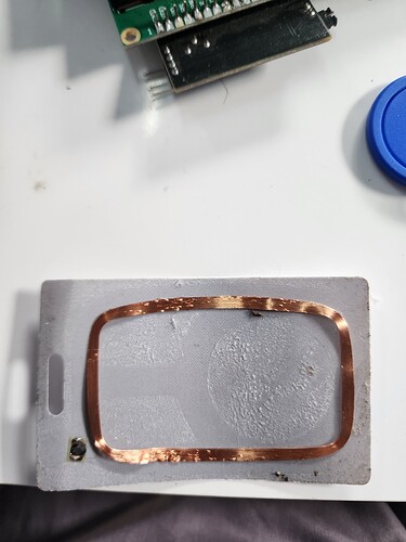

Problem Description: I am using an Arduino Uno and an MFRC522 RFID reader module for my project. The module successfully scans blue key fob tags but does not scan white RFID cards. Both types of tags are supposed to be 13.56 MHz and compatible with the MFRC522 reader.

here is the photo of those cards
The RC522 module is commonly used with MIFARE Classic tags, and whilst it can also work with other 13.56 MHz RFID tags that follow the ISO/IEC 14443A standard (like MIFARE Ultralight, MIFARE DESFire), true compatibility may vary depending on the specific protocols supported by the RFID tags themselves regardless of the frequency (the tags could use a different protocol and encryption method compared to standard ISO/IEC 14443A tags).
➜ your tags seem pretty thick compared to the usual MIFARE Classic credit card like tags used with the RC522 module - and if they are used for business purpose they might have a stronger security than the one found in MIFARE Classic tags.
You would need to know the exact standard they support.

I have seen tags like that in the past. These have always been RFID cards in the 125 to 135KHz region. Also these have always been programmable cards, as opposed to the normal thinner read only cards.

i tore down one card as u can see in attached image , can it work with the RC522 module?
No. Too many turns on the coil for 13MHz. That is a 125KHz cad.
If you can get a signal generator, get it to produce 125KHZ, and attach it to one coil like this through a series 10 to 32 Ω resistor. Then measure the voltage across the resistor using an oscilloscope you should be able to spot the resonant frequency by seeing where this voltage reaches a maximum.
