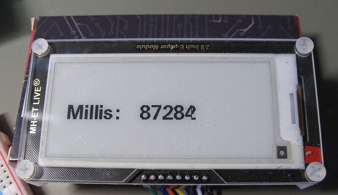

Hello! I'm testing an MH-ET Live 2.9" E-paper display (BW) with ESP32-WROOM (D1 MINI). I have a very simple test code using this example: E-paper display using partial updates | Arduino Project Hub
The code differs in that I don't have a Waveshare board and so not a V2 definition but the panel should be similar. At least the type seems to match the definition of 290_T94 and printing text works after full update.

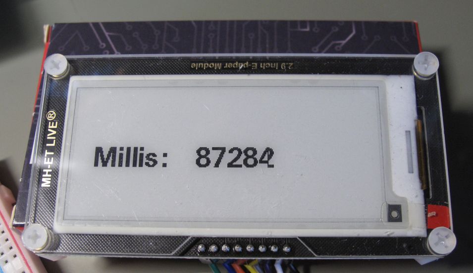

Partial update does work but there are some issues. Some characters get corrupted or rather they do not get updated properly (see attached image). Any idea what could cause this? The image is just one example and the "corrupted" character is mostly in the same position while the other characters update just fine. It's not always (but it is most often) the last character either but it always is only one of them.
Weird thing is that when I use a much smaller font (eg. u8g2_font_7x14_tr), there is no issue.
I have tested a full screen partial update and that does not solve the issue so it's not about the partial update window size.

Try this:
// For partial update test
  display.setPartialWindow(115, 50, 200, 40);
  display.firstPage();
  unsigned long timeNow = millis();
  do {
    display.fillScreen(GxEPD_WHITE);
    u8g2Fonts.setCursor(120, 80);
    u8g2Fonts.print(timeNow);
  }while(display.nextPage());
  delay(2000);
@Pete4 Hi,
It is always a good idea to start with an example of the library you use.
GxEPD2/examples/GxEPD2_Example at master · ZinggJM/GxEPD2 · GitHub
There you might take a look at GxEPD2_display_selection_new_style.h and at the different driver classes supported for you display size:

But from the picture you have a panel from Good Display with wavetable for differential refresh in OTP.
Hi @PaulRB , yes, you found the reason!
A value printed in the page loop should not change inside the loop.
A small display panel with ESP32 should not need paged display, but is forced here with
