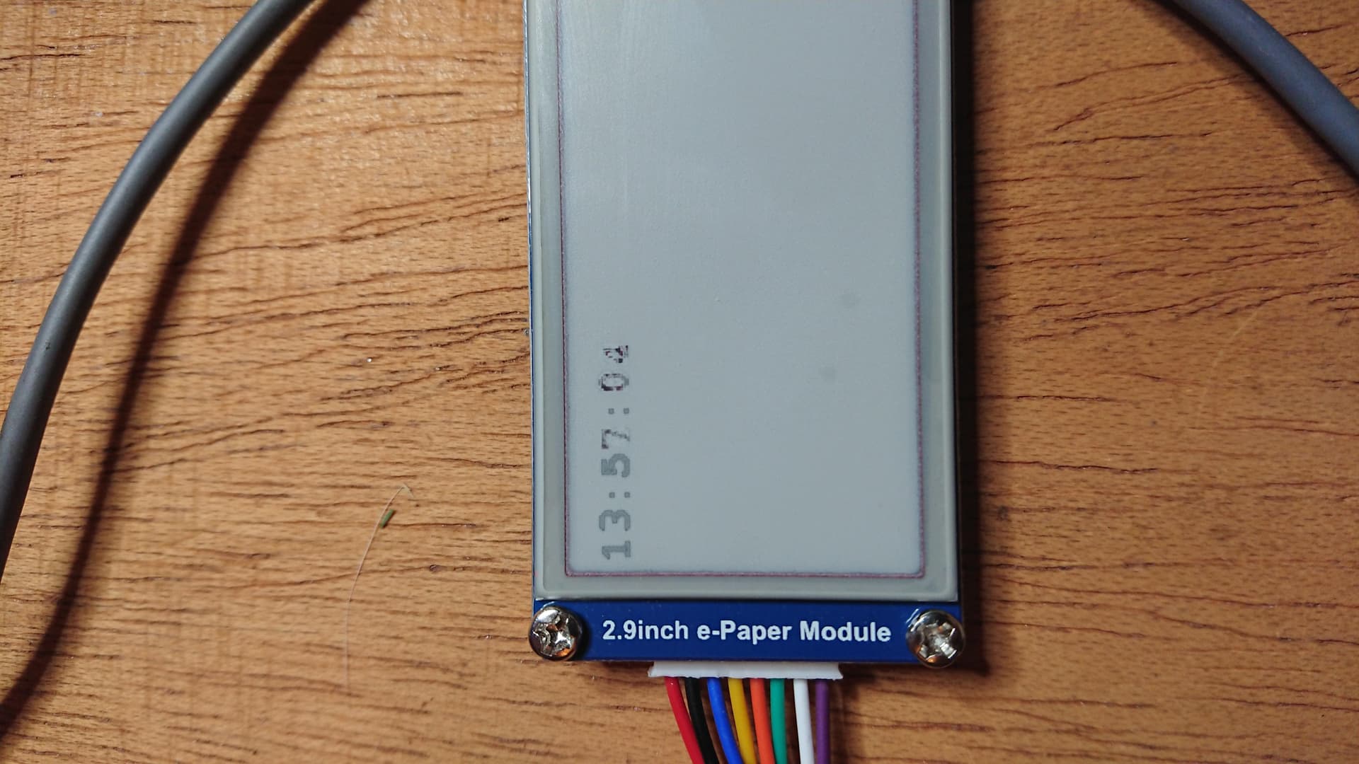

Problems with GxEPD2 and partial update
Howdy,
I'm trying to use an esp32 (Lolin D32 Pro board) with an waveshare epaper display (2.9" BW) utilizing the GxEPD2 library. Everything works fine as long as I print directly to the display. However, using partial mode doesn't really work and I don't understand what's wrong. But since the example works, it must be something with my code.

Running this code results in this on the display:
On the serial monitor I can see this:

So, what's wrong here? The stuff which can be seen on the display looks like the top or bottom 1 or 2 pixel wide line of the printed time. If I print more (e.g. also the date), then this scattered line gets wider.
I also did not understand the positioning of the cursor. From the logical point of view one would assume, that setCursor() uses coordinates relative to the current window (or full screen if not inside a window), But whatever values I tried, nothing worked.
It would be really great if someone could help me understand this.
Thanks in advance,
Tom

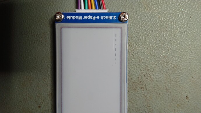

Ok, I managed to fix this by postioning the y point cursor 20 pixel below y of the window in timeBoxCallback():
display.setCursor(p->x, p->y+20);
However, now that the partial update works, another problem occurs:
The numbers which have changed so far, look a liitle fuzzy.
Any idea why it looks like this?

It works, but still generates these strange artifacts.
No. Remove while (display.nextPage()); if you want to use the callback method.
Consider reading GxEPD2/README.md at master · ZinggJM/GxEPD2 · GitHub.
Hi Jean-Marc,
glad to have you help, I really appreciate this :slight_smile:
So now I have it changed to:
  while (1) {
    getClock();
    display.drawPaged(timeBoxCallback, &boxParameters);
Works a treat but the strange artefacts of overwritten numbers persists.

However, the weird rendering of characters is the same with the example code as in mine. No difference at all.

And why does the display work when programmed via IDF (at least displaying something) but not when I use the Arduino IDE?
You need to update the package download link, then update to actual (2.0.1)
Your board may be from rejects, e.g. have a wrong RESE resistor value.
Hi Jean-Marc,
oh indeed! With 2.0.1 the display works but still shows there artifacts. So it seems nothing have to do with the build environment but the display itself.
I've read the Waveshare FAQ again and they state that the display should be set to sleep mode or power off after use - which I never did. In fact it lay 2 or 3 years in the drawer. So maybe it's just bricked.
Is there any resource where I can read more about this? Maybe I could replace the resistor myself?
Thanks a lot 4 your effort so far!
Tom
