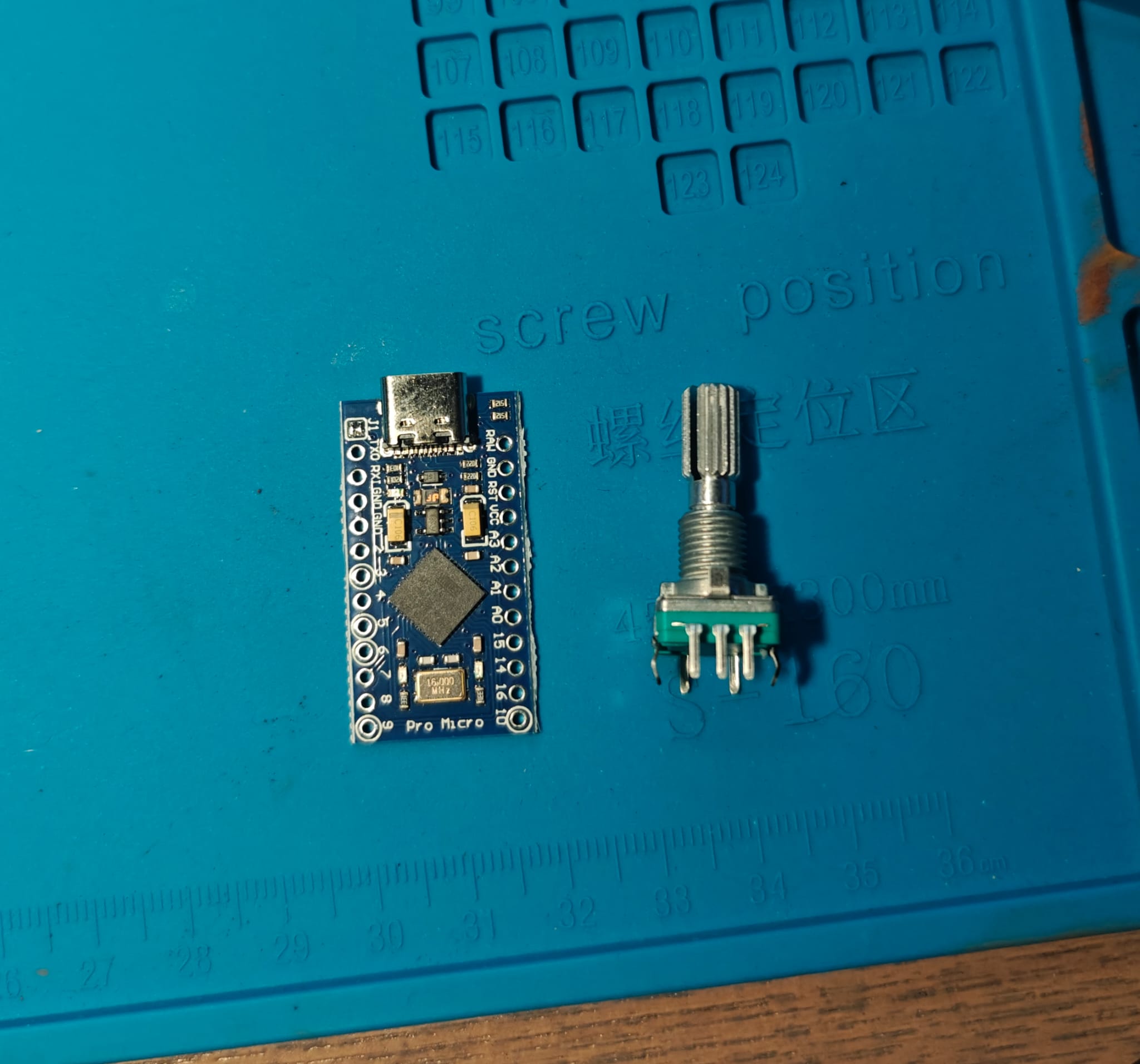

I have found several topics here but I am not experienced enough to follow along with the solutions.
I have micro pro and rotary encoders. I have a flight sim with a helicopter collective that is in desperate need of a throttle addition. I think this is the way to do it. I also have an ESP32 if that is a better option.
I have no idea where to start. Anyone willing to help?

Larry, thank you for replying.
Yes it has a push button switch that I do not require for this particular project.
Honestly, I need help with quite a bit. I'd love to know the best way to get this rotary encoder wired to the micro ie where to terminate. And then what the best code would be.
It will be a twist throttle meaning clockwise would increase the helicopters throttle. And anti-clockwise would decrease. Or visa versa

I have used QEI decoder library using interrupt on change to detect changes in the A and B levels on a number of microcontrollers ESP32, Leonardo, ETC - tested with rotary encoders similar to the one in photo in post 1
should work on a pro micro

I have those same rotary encoders as well, I didn't get them to work properly until added 10K pullup resistors to the pins (INPUT_PULLUP from the board turned out to be to weak) and 100nF de-bounce capacitors (Pin to GND)
Then i created this test sketch to run on a Pro-mini using pin change interrupts. Now since it is using direct port manipulation it won't be working on a micro without modification. Actually i probably shouldn't post it but it may be helpful. I will set 1 encoder up with the pullups and the capacitors later and get it to work with the micro. The Pin Change interrupts seem rather different than on a Pro-mini though, so bear with me. You can also do it using the normal interrupt pins on a Micro, that may be easier to accomplish.
The basic idea is that you connect either the A or the B pin to an interrupt pin, and connect the other to a non-interrupt pin, Set the interrupt to 'FALLING' and read the status of the non-interrupt pin, which will tell you the direction the encoder was turned. For this type of encoder that is exactly what you want, but without the 10K pullups & the capacitors, all bets are off.

Just as an update, dug up an unused micro, grabbed an encoder like the one shown by the OP. (EC11) Added 100nF capacitors between the A / B & GND and added 10K pullups to A & B pins.
Put this on a breadboard, which of course makes it a tad unstable, but when i hold the encoder while i turn it, it's OK. Will make a small testing version later that is soldered.
Wrote this
#define A_PIN 2
#define B_PIN 15
volatile int8_t counter = 0;
  while (!Serial);  // for native usb boards
  Serial.println("Encoder on a Micro");
  pinMode(A_PIN, INPUT);
  pinMode(B_PIN, INPUT);
  attachInterrupt(digitalPinToInterrupt(A_PIN), Count, FALLING);
  static int8_t oldCounter = 0;
  int8_t loopCounter = counter;
  if (oldCounter != loopCounter) {
    Serial.print("New Value : ");
    Serial.println(loopCounter, DEC);
    oldCounter = loopCounter;
  delay(1);
void Count() {
  if (digitalRead(B_PIN)) {
    counter++;
  else {
    counter--;
This uses an 8 bit variable as a counter, so interrupts can remain enabled while reading / copying it.
Only 1 interrupt pin per encoder is used, so with just the external interrupt pins you could use 5 encoders.
Works like a charm.
