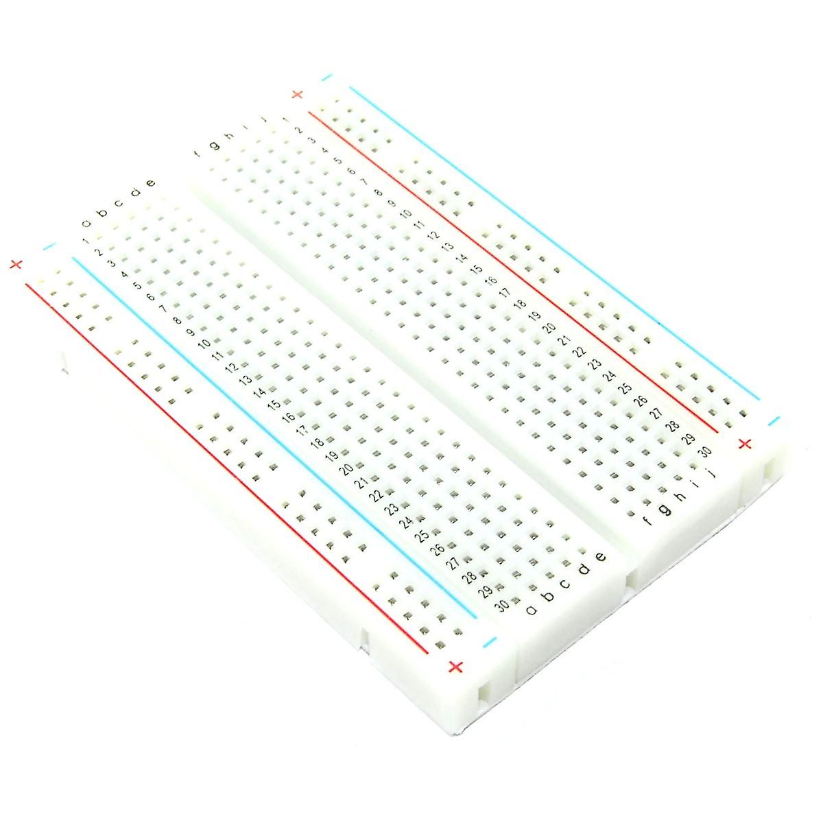

It is quite common to test out your hardware with "solderless breadboards".
This way it is easy to make changes, until you are confident about your hardware setup. By soldering "header pins" to your Pro Micro, you can easy fit it into a breadboard.
When you are ready to make your project more permanent, rather than tightly wiring the modules together, it is more common to mount it on some kind of "protoboard", or "stripboard"
protoboard
Unless you have a particularly good reason, tightly wiring everything directly together, like in your photo, can cause a lot of headache. Breadboards and protoboard are common for a very good reason: they make life easier!
