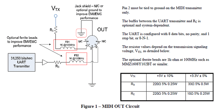

The MIDI electrical specification was updated to version 1.1 in 2014 to include 3.3V signaling.
The familiar 2 x 220Ω resistors found in 5V MIDI transmitter circuits are reduced to typically 33Ω and 10Ω in 3.3V circuits as detailed in the attached specifications.
2014 MIDI V1.1 Specification.pdf (240 KB)
From the MIDI V1.1 Electrical Specification:
MIDI OUT Circuit:
Yes i see that. thanks. But how much current does the circuit actually draw?
The current flowing out of pin 4, and back into pin 5 should be 5mA, when the correct load of 220Ω and the LED of an optoisolator is connected.

I can't measure 5mA. There seems to be much less than that.

This is because when the MIDI line is set at the idle state it draws no current.
Then when you send a MIDI message the current draw fluctuates between no current and 5mA depending if the serial is transmitting a zero or one at this time.
If you are trying to measure this with a DVM you have two problems:-
  1. The current you will see is an average current which will depend on the message contents and the number of messages you will transmit per unit time.
  2. Your DVM probably won't measure such rapid pulses anyway.
To measure the current you need an oscilloscope, measure the voltage across the series resistor and do the sums.

It is not needed because the transmitter only ever sees the LED and seriese resistor from the equipment it is connected to.
You have to watch however that the 3V3 signal pin can provide the appropriate amount of current, some processors are limited in the source current certain pins can supply. It has to cope with the current required if the signals are swapped over, that is the resistor is in seriese with a diode and not an LED.
Great. It can sink and source 50mA, so that should be adequate
