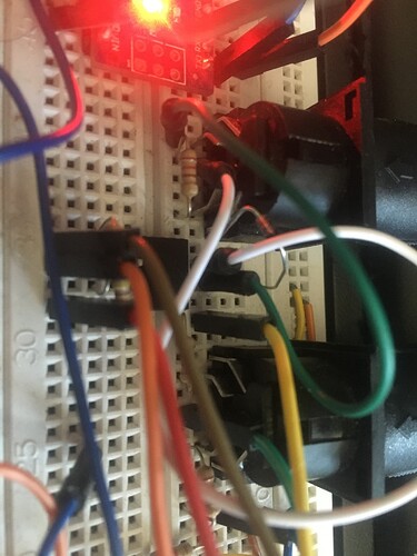

I'm having an issue using my sketch that remaps midi channels in-line on my UNO boards.
You can find the code for my Arduino Nano build here.
I'm using this schematic as laid out by the MIDI Association. I'm using a 6n138 on each build.
Everything works as it should on my Nano, but I need more Arduinos and I found some UNO boards cheaper than Nanos.
I've uploaded the blink Sketch and it works fine, but I can't seem to make the MIDI signal communicate with the board. I've swapped the boards with each other and the Nano works on both circuits. I've tried all the UNO boards with no luck. The serial activity LEDs aren't even flashing, but the midi does interfere with sketch uploading.
Am I missing something in the code that's UNO-specific?
Cheers
Kempy

We need to see what you have actually built for the two processors. That means good quality photographs. Also please post your schematic, not links to it.
You might want to look at this How to get the best from this from this Forum before you proceed any further. It tells you what you need to post for asking a question.
They only flash when connected to a computer it is that flashes them not the Arduino.
Well it should, this implies incorrect wiring.
Schematic:
UNO Circuit:
Nano Circuit:

On the Nano, the RX and TX LEDs flash when data is read and written respectively, as well as the LED_BUILTIN flashing with each piece of data being remapped. Uploading to the board is blocked (as it should be, caused by the MIDI stream over serial)
On the UNO there is no flashing on any of the three lights, but it still blocks the upload of a new sketch.
Thanks for posting the pictures. It is a bit difficult to see what is going on.
What I noticed on the one of your Uno clone, is that you have the ground connected to the red bus bar of your bread board. Not in itself a problem but it could be confusing later on. Conventionally red is for positive and black is negative. I know from teaching international students that this is not always as deeply engrained as it is in the West.
I notice that your Nano and Uno do not use the same solderless bread boards for the peripheral circuits, so maybe there is a mistake on the Uno one. Or something is not making a good connection on the solderless bread board?
It looks like the Uno clone uses a CH340 serial to USB chip, is the Nano also a clone with this same chip? As I said both Uno and Nano use the same processor chip.

The official UNO uses the Atmega16U2 for serial communications.
The official nano uses the FT232 for serial communications.
Almost if not all UNO clones use the CH340G for serial communications.
The big difference with the CH340 implementation is that the serial activity LEDs are connected directly to the TX and RX (DO, D1) lines whereas the FT232 and 16U2 have dedicated pins for the LEDs.
I'm sure that the LEDs and current limiting resistors would interfere with the MIDI connections.

This is done strictly for ergonomic reasons and to avoid fatiguing the front plate pins while keeping it as a grounding point. When removing the DIN-5 plug from the port it tends to pry up from the back so it's easier to keep the edge of the port flush with the side of the breadboard.
When I tested with the Nano before on both circuits, it functioned as it should, I've checked for continuity with my multimeter at all points and I can't find any open spots in the circuits.
That actually makes a lot of sense. When I was looking at the schematics for the genuine UNO pinouts and schematics it lists the RX and TX LEDs on P4 and P5, respectively, which confused me.
I'll keep poking around and figure out if there's a discrepancy between the two builds that I'm missing.
