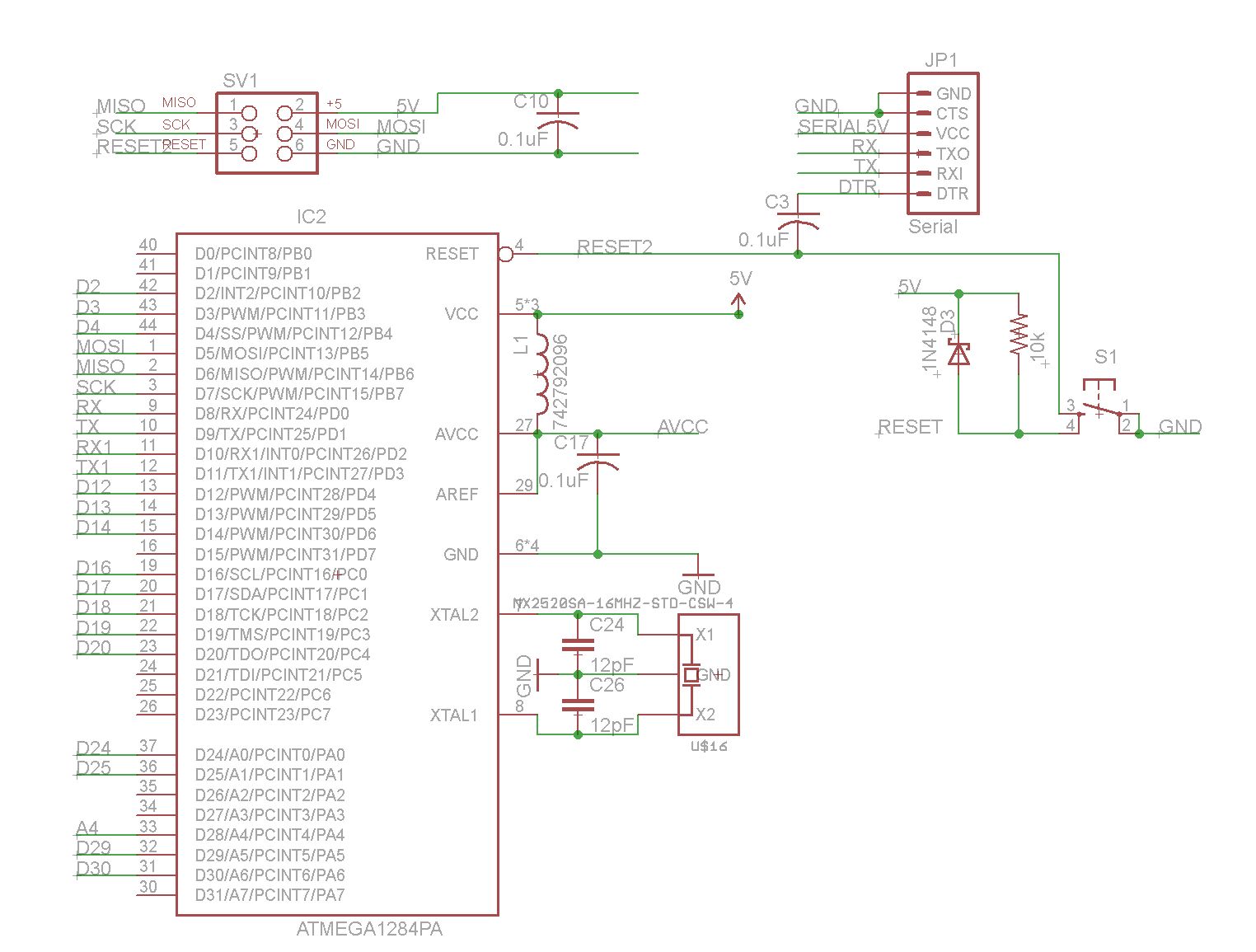

My question to the experts: Does the above suggest that the board is alive or may I have cooked the MCU in the reflow oven?

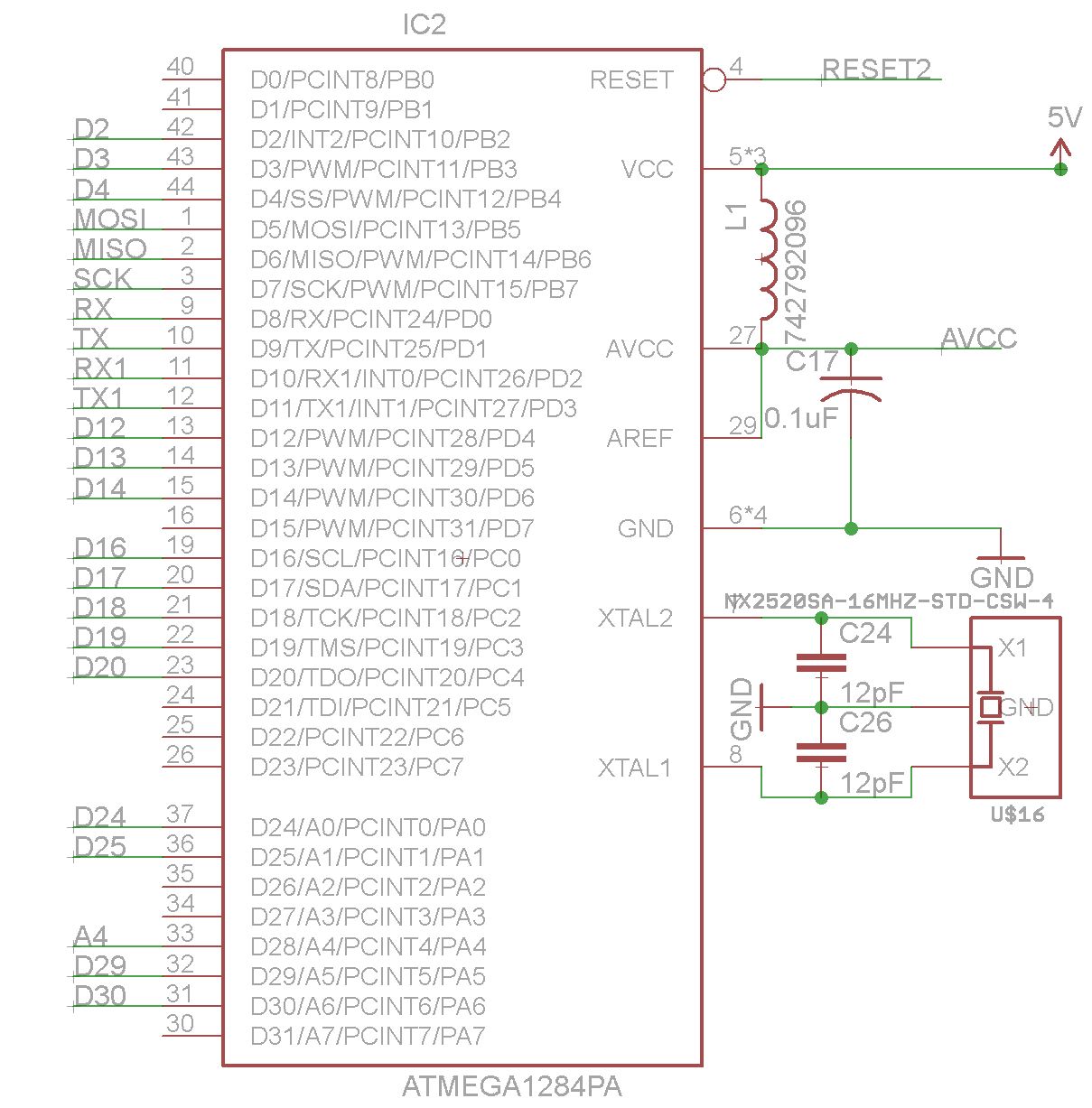

Now for the changes I made that may also be the cause of the above unhappiness: Instead of the resonators I have used in the past, I switched to a crystal: CS05116-16M NDK America, Inc. | Crystals, Oscillators, Resonators | DigiKey
Unfortunately, I managed to order the wrong version of the crystal - the 12pF load capacitance version instead of the 8pF model I intended to order. Thus, my calculated 12pF external capacitors are obviously wrong and need to be replaced. Would 20-22pF caps look like a better bet?
FWIW, I am running Arduino 1.6.1 on a OSX 10.10 machine. I downloaded the mighty library for version 1.6 from github... Many thanks to all again, this is an amazing forum and community.
Are fuses set to use external crystal as clock source? If yes, was that process performed successfully after assembling the board?
If yes to both, your crystal isn't doing it's thing - fix it and the chip will work.
Otherwise, suspect solder bridges or board design errors. My general process is - Check all isp pins and crystal pins for shorts to each other, power, and ground. Make sure power and ground aren't shorted, and check that each isp pin really does go to the right pin. Check with an ohm meter so you can find bad solder joints. Is reset at vcc when powered?Rework as needed. Did you put the isp header on the wrong side if the board?
I really appreciate the help. Here is the schematic:

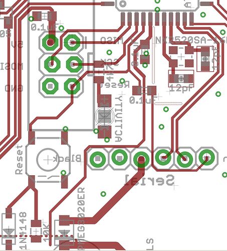

Here is the board showing the relevant connections. Note: the 1284P is on the TOP side, the ISP header is on the BOTTOM side. The header pins appear to be correct (i.e. MOSI to MOSI, and so on). I feel pretty confident that the connections are correct as I have used this ISP header many times while programming past 1284Ps and 328Ps.
At the bottom of that image, you can see the serial header with the DTR pin to the left. A track winds its way up to the RESET pin on the 1284P, with a 0.1uF cap bridging over one of the 5V lines to make the connection.
At the bottom of the picture and to the left, a 10k resistor pulling up Reset ties into the 5V supply. 5V from Serial snakes its way down from the serial header and dumps its power via a Schottky diode (this is how the board is powered during programming. In the past, I had no issues with this setup, i.e. Serial powering a board while the ISP burns the bootloader).

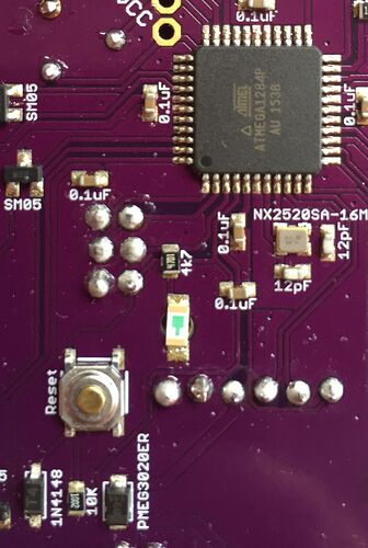

I checked for solder bridges and so far, I find none. I have attached a iPhone pic so you can see how the solder is distributed. For what it's worth, I used a stencil and a reflow oven.

I presume all is left is the caps on the crystal?

Thank you, Crossroads! Images are attached below.
Here is an image with the relevant headers and the MCU. Pretty standard stuff, I think.
Electrically, RESET and RESET2 are joined via the tactile switch. I confirmed the electrical continuity
Also 'walked' around the 1284P with a DMM and found no adjacent pins with less than 4.7k resistance between them, which makes sense since a number of the pins go to 4.7k pullup resistors. No outright shorts other than when the probes touched... AVCC, VCC, and so on are all at 4.9V, as expected. Power indicating LED is lit.
I also checked the electrical continuity from the ISP header to to three pins on the chip. All seems well there. Presumably, the MKII would not light up green if the polarity on the header was wrong?

Schematic & images look ok.

Are you using Full Swing Crystal Oscillator (low fuse byte ends in 7?)
