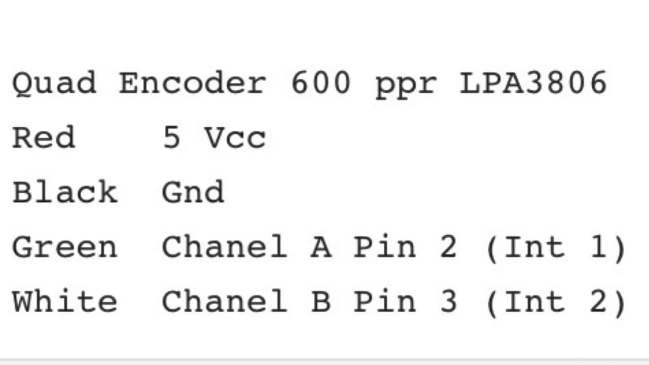

I am trying to use the exact encoder for measuring the rotational position of my chuck at my lathe but with an arduino leonardo. I have stripped your code of the display parts because I am trying to first do the output to the serial monitor and later to an OLED that I have already working. This is why I introduced the new variable "grad_counter ".
The problem is that the counter is only counting upwards and seem only to work half the 360° turn of the encoders shaft. I somewhat have the feeling, that the PIN address (PIND & 4; PIND & 8 ) that you are reading directly from are not the same for a mini as for a leonardo. Might this be the problem? Thanks for your help.
Here is 'my' code (I left the parts that I excluded in to make it easier comparable):

Hi CircuitOfHappyness
I don't know exactly why your setup is not working. Could be a failure on reading the state of the digital pins 2 and 3 (PIND) or that only one of the two interrupt lines are occurring. I think you are right about the problem been on the differences between Arduinos Mini and Leonardo.
PIND&4 and PIND&8 tests the register D for the levels of the third and fourth bits (right to left). These bits corresponds for the digital pins 2 and 3.
I've used Arduino Mini Pro, processor ATmega168. Leonardo uses ATmega32u4. I don't know if they work the same way.
Apparently the interruptions inputs are also different. See: Arduino Interrupt
Do you have a Mini or Uno to test ?
Looking at the datasheets for the Atmega32 (Leonardo). It is really different from the Uno/Mini.
Try using:
PIND&1 instead of PIND&4
PIND&2 instead of PIND&8
Or, use
digitalRead(2) instead of PIND&4
digitalRead(3) instead of PIND&8
The option for digitalRead is much slower; it may not work, depending on the frequency of your pulses.
Wagner
Thanks. ![]()
This setup worked:
I tested my code with a mechanical encoder to see if the ports are addressed correctly. So far I am fine.
It seems that the encoder (LPA3806) is not working properly. I checked if the manufacturer has a cable twist, but everything seems al right according to this
Rotary encoder teardown (LPA3806-600BM-G5-24C)
I also tried to connect two LED's to the encoder, turn the shaft slowly and check if they are blinking. They don't! They do even not light up at all. Only if I remove the ground pin the LED's start constantly glowing.
I guess I will contact a friend with a scope to check if the encoder is broken, or are there any other ideas form this community?
O.K. I fiddled around some more.
The green channel is working and triggering the interrupt B. The white one is not responding on interrupt A. If I switch the cable at the arduino than green is triggering interrupt A. White remains dead.
This results in the counter just going +1 and -1 so the output is
0
1
0
1
0
you get the point.
Nevertheless I will go for the scope in the next days.
Tested it with an oscilloscope. White channel is dead. >:( Ordered a new one. I hope the next one is O.K.
See how the test went:
Thanks a lot for the help.
Hello,
Please be aware that the outputs of the encoder are of the type "open collector".
They need a resistor pulling then up to the 5 V line.
On my project, the resistors are provided by the microcontroller. See the code: pinMode(QCA,INPUT_PULLUP);
I do believe that your encoder is defective.
