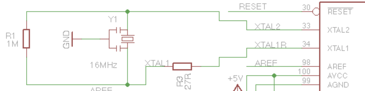

I've got a crystal on the board, but I don't know how to check if it's working. I've tried using the board detector sketches clock on pin 9, but it doesn't seem to be doing anything - I couldn't see how it was working in the code either.

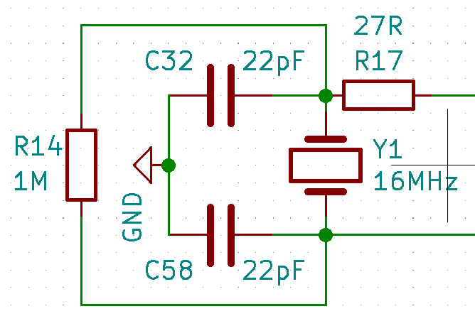

Scope XTAL2. Why is there a parallel resistor in your xtal circuit? Do you have a true quartz crystal, or a resonator? I'm not sure but isn't 22pF kind of small for the reset circuit?

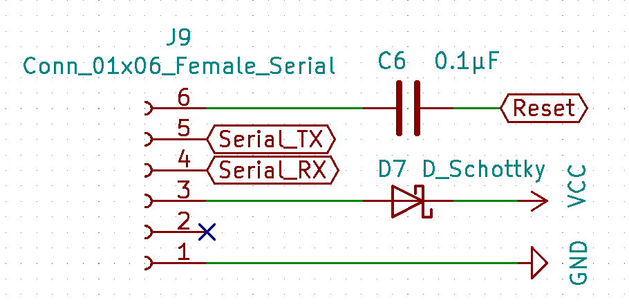

The official Mega schematic has this capacitor. I'm not sure what its purpose is. The essential auto-reset capacitor is a different one: C7 on the official schematic.

The crystal is a ECS-160-12-33Q-JEN-TR - data sheet here. Perhaps the caps may be slightly off now I've read into it a bit more.
I put the resistors in the crystal circuit purely because I saw it in the Arduino schematic. Probably not the best way to design a circuit, admittedly.

You're right re the reset capacitor; I got it from the Arduino schematic. I also do have the C7 one...

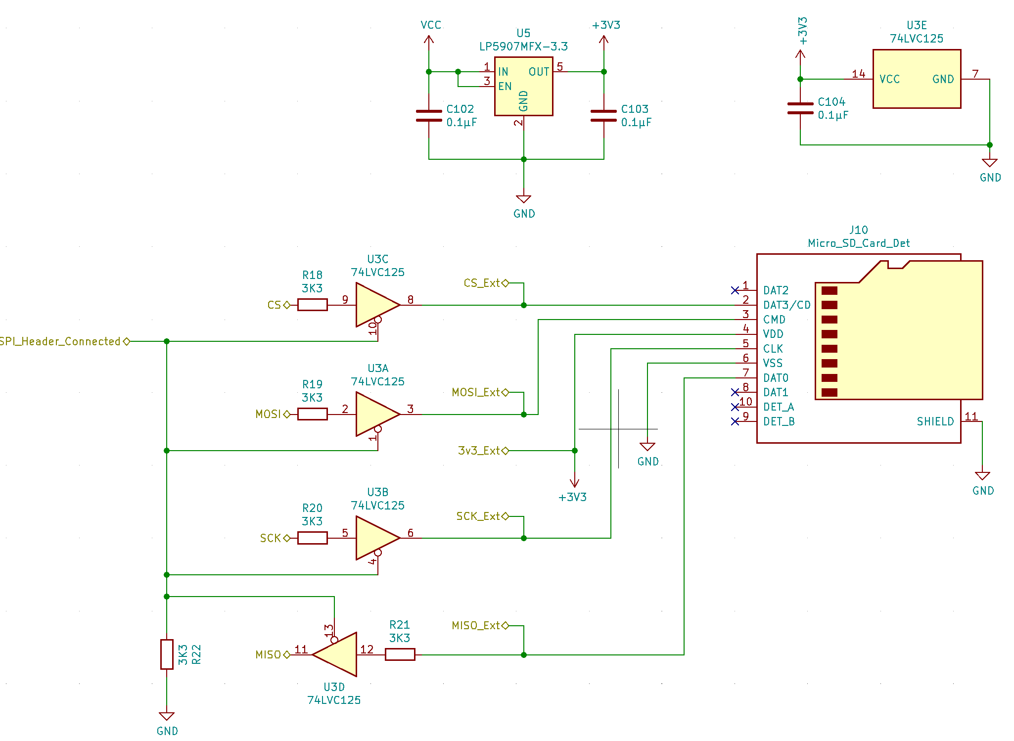

Here are the other bits of the schematic I think are pertinent to the SPI...
I'm trying to use an SD card as well (currently none inserted) and I'm using the 74LVC125 as a level shifter and also to allow a future hex loader function (also based on Mr Gammons example). The main board will use the SD card normally, and a separate board will be plugged in and use the SD card for uploading the hex file. This is a problem for future me to worry about, assuming it's not this bit of the circuit that's the problem.

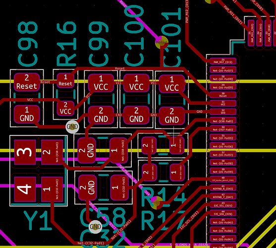

Thanks for the link. Regarding the layout, my capacitors aren't as suggested there. They are all grouped together near pin 26 (see original post for image). Will this be major problem?

The oscillator circuit on the Mega is for a resonator. The device you linked to is a quartz crystal. The 1M resistor doesn't belong there, also the 27 ohm is a random addition that should go. I'm more concerned about a lack of pi network capacitors (because the schematic component for a resonator may show them built in, but they may not be on the board, am I right?). On other quartz circuits, you'll see a pair of 10-22 pF capacitors on the two sides of the crystal. Those are necessary for stability.

How possible? They are not shown as discrete components. How did the EDA translate that into a PCB footprint for the caps? What value are the caps?
Do you mean C32 and C58 on my drawings?...
If not, then no, I haven't included any others, and I still don't follow.

Sorry, I was looking at the wrong drawing. It will work, you can put a zero ohm resistor where the 27 ohm one is and omit the 1M.
Ah, I see now. The Arduino schematic I posted. Sorry for the confusion. Thanks for the advice on the resistors. :+1:

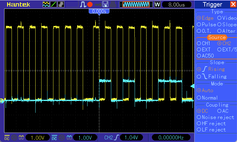

Please have a look at this scope reading...
Channel 1 is SCK
Channel 2 is MISO
So am I correct in saying it is responding, but the amplitude is too low? When I look at the MOSI signal it's up at 5v -ish, matching the SCK amplitude.
Are the spikes anything to worry about?
Purely out of curiosity, which schematic is that? I haven't seen something like your R17 before. I'm just a little interested in understanding more about it.
Capacitors are not an exact science. There are some general best practices such as what is recommended on that schematic, and then there is what you can get away with, which might even go all the way to leaving caps out entirely if you are lucky and not concerned with reliability. I have seen some professional PCBs where the caps were a fair distance away from the chip they provide decoupling for. Likely there were manufacturability considerations that influenced that placement and the engineer determined that it was safe to place them there even though not ideal.
All that is a long winded way of saying: "I don't know".

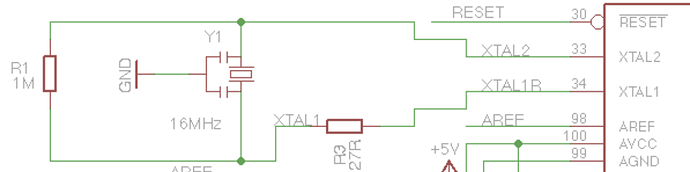

This is from the Arduino Mega2560 schematic...
And this was from the RobotDyn Mega2560 Pro Embed schematic....
From what aarg said above, I understand now the parallel resistor is used for resonators, not crystals. The Arduino R3 27R one, I have no idea.
That makes two of us!

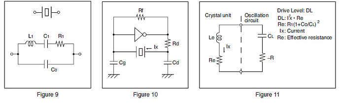

This resistor is the feedback register of the crystal oscillator circuit.
If you want to know more about this resistor,
please googling "crystal oscillator feedback register".
EDIT:
p.s.
It is often unnecessary for the oscillator circuit built into the microcontroller.
If you make your own CMOS oscillator circuit, you should add it.
I've made some progress with this, but hit another wall.
Like I said in an earlier post, I've got this part of the circuit which is intended to allow the board to use an SD card, and also in the future allow another board to be connected and use the SD card / SPI to load a Hex file to the processor. So I have the 74LVC125 to shift the voltage levels and also allow the SPI to be isolated. I had a thought that the MISO signal was being pulled low because the enable signal on the 74LVC125 was low and there is no SD card connected. So I stuck 5v on the enable, giving the MISO output on U3D pin 11 high Z.
And it worked! ... For a bit.
