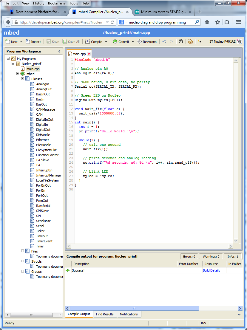

The ARM mbed development site is a great way to try bare metal STM32 with an Arduino like environment. You don't need to install any software, just develop on the website and down load the bin file. If you choose, you can install the open source libraries locally. With Nucleo you just drag and drop the bin file into the Nucleo mass storage volume that appears on your computer.
Here is output from a simple test program that writes the time in seconds and analog value to Serial monitor while blinking an led. See the attached screen dump of the development environment.
Hello World !
1 seconds. a0: 982
2 seconds. a0: 1012
3 seconds. a0: 1013
4 seconds. a0: 1013
5 seconds. a0: 1034
6 seconds. a0: 1008
If you click on a class, you get the documentation. I attached the top of the documentation for Serial.
There are many third party libraries available. For example there are FAT files systems libraries for SD cards, USB keys, and other devices.
The total cost here was $10.33 for a NUCLEO_F401RE with 512 KB of flash and 96 KB of RAM.
