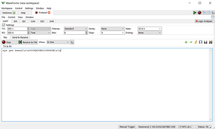

I am using a MKRZERO connected to a microchip RN2903A LoRa radio in the following way:
MKRZERO tx(pin14) --- RN2903A RX
MKRZERO rx(pin13) --- RN2903A TX
MKRZERO pin2 --- RN2903A RESET
I am unable to get the arduino to receive replies from the radio. When I run the code below, I can see that the correct command is sent to the radio, and the radio replies with the expected value, but the arduino doesn't seem to receive it.
In the console, it prints out "Communication with RN2xx3 unsuccessful. Power cycle the board."
Using an Analog Discovery 2 to "spy" on the serial commands, I can see that the radio receives the request for the hweui and then replies with it (shown below in image) but the arduino seems to do nothing with it?
The original library used software serial, and I have modified to use hardware serial, so perhaps the issue is there? Any help is appreciated!!

See TX and RX on the same line:
At least GND is missing. You might have done that but that again shows why we ask for a wiring diagram and not descriptions of your connections. How do you power the chip?
As you don't link to a breakout board we expect that you directly connect to the RN2903 micro board.
The flush() method doesn't empty receive buffers (it seems to me that you expect that).
