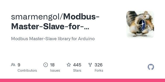

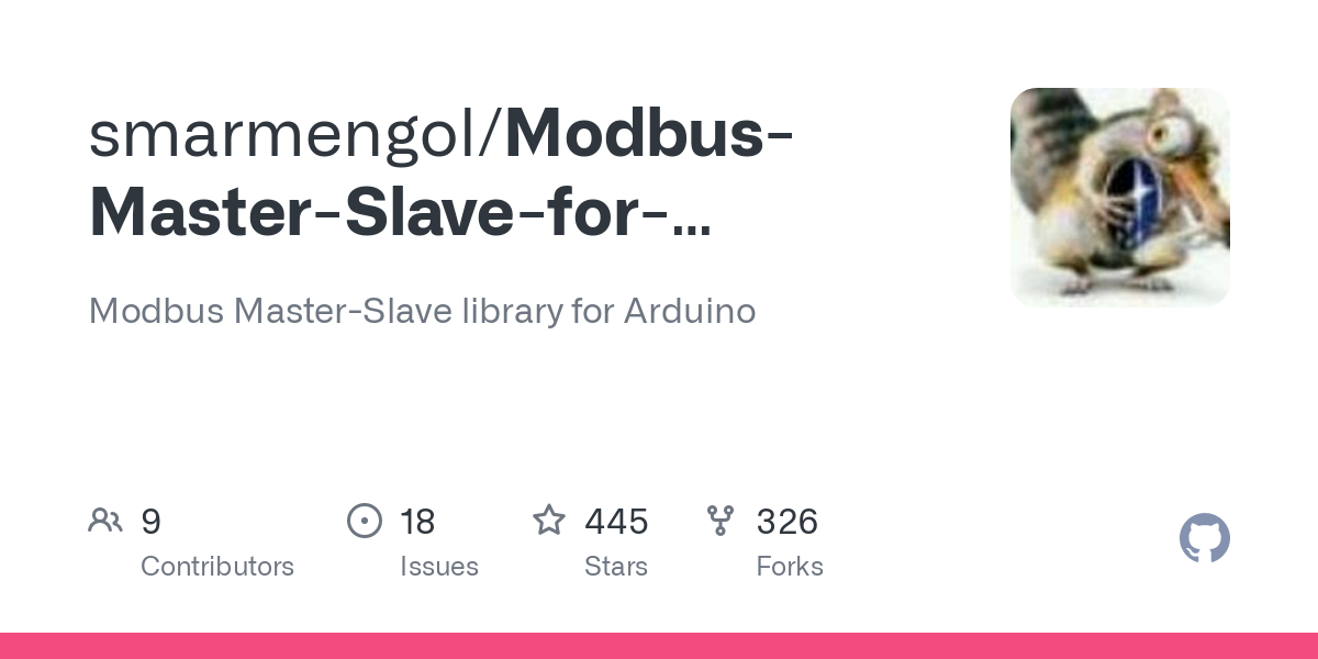

I used this library a couple years ago.
It is not for STM32, but worked with bluepill without issues.
You may have to slightly edit the variable types there, for example, replace int with int16.
