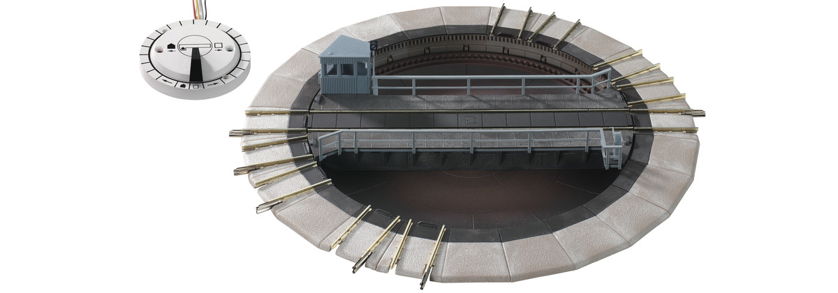

One thing puzzles me: in my mind a controller is a panel with buttons, a microcontroller board or a combination thereof.
If this is super dodgy, why replace motor and encoder?
Other questions:
Does your turntable have a locking mechanism to position and lock at every exit?
Are the exits evenly spaced (like Fleishmann 15°, Märklin 12°)?
Will it be manual control (stop at the next exit) or automated (house end or non-house end at exit number #)?
It is a button directly connected between the power supply and a motor.
The current system is garbage. The motor is a little 5v thing that is gutless, the belt drive slips if it's loose enough not to break, and breaks if it's tight enough not to slip. It is not smart, rather you hold a button down till it's the right spot and then release.
Yes, it currently has a solenoid that clicks in, when it stops moving, you release the button. To move to the next spot, you have to press and hold the button again.
Unfortunately, no. It has been customized.
We want it automated. Press a button, and it automatically moves to the corresponding spot. Or to just turn 360 for turning the train around. I was thinking one button per track, and one extra as a 360 button.
It is for a HO scale layout.
For an automated system I suggest not those buttons.
To start a movement: push a button for house end or one for non-house end and one for the exit desired.
A button for 360° is useless, you might wish to turn the table 180°, but that can be done with the buttons here above.
Whether you count the exits passed or use an encoder, the ‘zero’ problem remains.
You addressed two different (independent) problems: motor and control.
Automation of control is a wish, solving the motor problems is a necessity.
I assume that the motor, flimsy as it may be, is strong enough to move the turntable.
I also assume the driving belt is a V-belt, it may have teeth for use with smaller belt wheels, but it’s not a timing belt (correct me if I’m wrong).
A small amount of grease may cause slippage of a V-belt.
Unfortunately, cleaning agents you might use for cleaning the wheels may attack the belt itself.
I’m looking at the Fleishmann stuff for ideas, they have more experience with model trains than I have (duh).
Fleishmann wants the user to release the knob before the desired position is reached.
From your description I understand that in your case the user releases the knob (or button) after the turntable got locked.
This causes the belt to slip every time, smoothing the sides of the belt, making it lose friction.
Depending on the actual control mechanism, saving the next V-belt may be in educating the user.
You make it so that when the lock engages, the motor is turned off, no matter what position the button is in.
I’m not gonna buy an item of several hundreds of dollars to study it, so I’m making a (educated) guess as how the Fleishmann turntable works.
When the user pushes the knob the lock is pulled and the motor starts running.
When the user releases the knob the motor and lock coil are no longer energized, but the turntable will keep on moving on inertia, the lock pin comes out and slides along the wall until it finds a hole to lock in.
The user will learn by experience to watch the movement of the turntable and not release the knob too soon.
