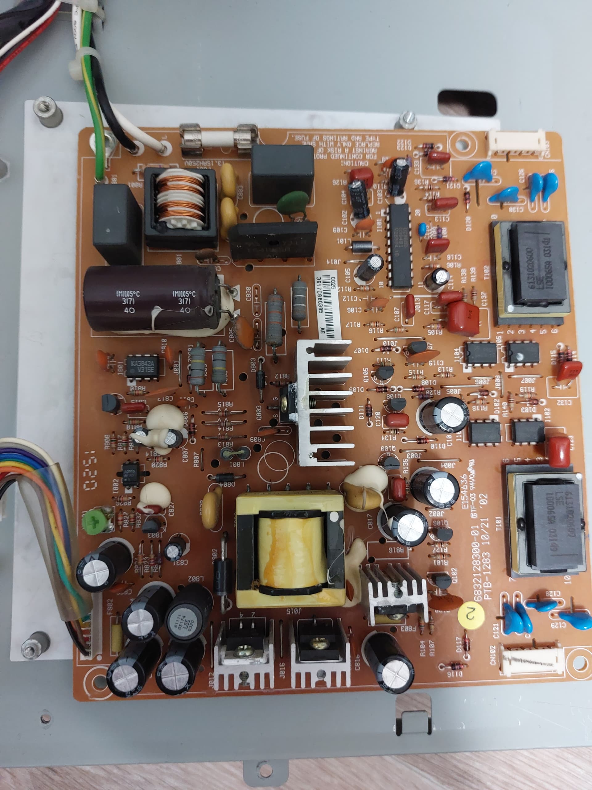

Hello, i've managed to get some old lcd display, it does have 2 boards. I have no idea how to hook this up to my ardiuno. If possible it would be great to replace those circuit boards bcs they are kind of bulky.
Thanks in advance (Panel is manufactred by AUO model no is :M170EN05)
Google suggests it is a 1280x1024 RGB device.
What were you planning on doing with it?
Firstly i would do some data displays form sensors, maybe more advanced projects in future
Do you have any documentation for its controller?
No, my grandfather foun it in his jobs warehouse,
Ok, here's one.
