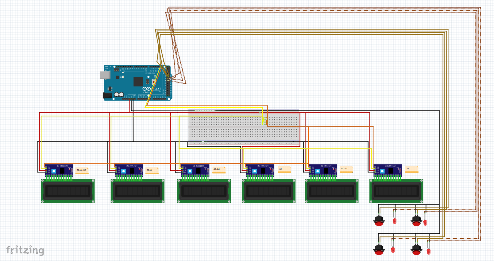

Hello,
I want to make a different display on an LCD screen with 4 push buttons.
That is to say, when I press button 1, the screen shows me an information, on button 2, another one...
I would like to have the code of this project.
Thanks in advance

You said, "an LCD". Now I see six. Please post a wiring diagram. If each display has on board pull up resistors, that is too much load on the I2C driver pins.
Is there some problem with your program? You didn't actually say...

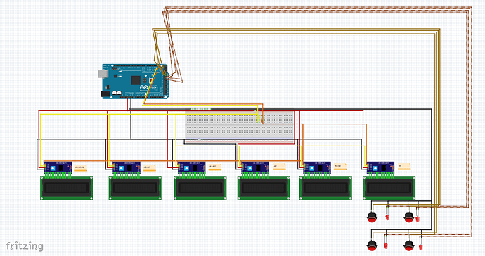

I don't know. I know that when I press the buttons, the screens do not change display. They all display at the same time
Thanks for the diagram. It's helpful. But a spiderweb as most Fritzing diagrams are.
It sounds like you have not done any "divide and conquer" troubleshooting with simpler sketches and tests.
Did you at all investigate the I2C pull up resistor issue I mentioned?

The solution for the I2C pull up resistor is put a resistance of 2.7 Kohm or 4.7 Kohm ?
And for my code, it is correct ?
Thank you in advance fo your answer ![]()
None of those questions can be answered yet, because you do not answer questions.
I ask you about pull up resistors, you post the same diagram again with no explanation, and ask again about pull ups. You have not investigated or made measurements.
You ask about code. You were asked, in what way doesn't it work, you did not answer.
If you want help, you have to answer all the questions you are asked. A question is as much a route to a solution as is a statement.
