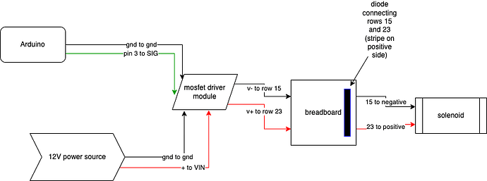

Thanks again for the help - I think I'm close but now the solenoid does not reach the powered on state. I am using a brand new module and diode. Here is my updated diagram, which is not as clean as yours (side note what is that diagram tool thats sweet).
Again first time doing much of this I used a breadboard to try to allow for that diode connection but let me know if I have misstepped there.
Essentially the different connections are
module (V+) -> breadboard (BB) 23g
diode stripe -> BB 23i
solenoid + -> BB 23j
module (v-) -> BB 15g
diode blank side -> BB 15i
solenoid (-) -> BB15j
and I ditched the 5V connection
Does the solenoid not turning on mean I don't have enough power? Or have I just wired something wrong?

This would suggest a short somewhere, likely in the mosfet module.
Your solenoid is in good order.
I would avoid putting the breadboard in the path unless you have no other way to connect the diode across the solenoid.
Edit: I looked at the link for the driver, and I could not find a schematic. I did see that a reviewer had put up a schematic, but I am not sure I would trust that one, since it shows that both the resistors are shown connecting the mosfet gate to ground (one via an LED).

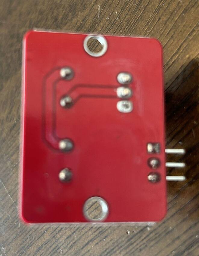

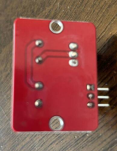

Post a clear well lit photo of the module (front and back) with no wires attached so we can see the terminal labels.
Is your Arduino 3.3V or 5V, IRF520 is not a logic level MOSFET, 3.3V may not be enough for 460mA output.
Here are pictures of the back and front of the module
OK, now tell us what is connected to each terminal.
It has 5V and 3.3V pins - so I guess its a 5V arduino. I power the mosfet with 5V but have tried using the 3.3V to supply power to the VIN pin, I did this just to check if the module was working appropriately - which it seemed like it did at that voltage when powering a DC motor
