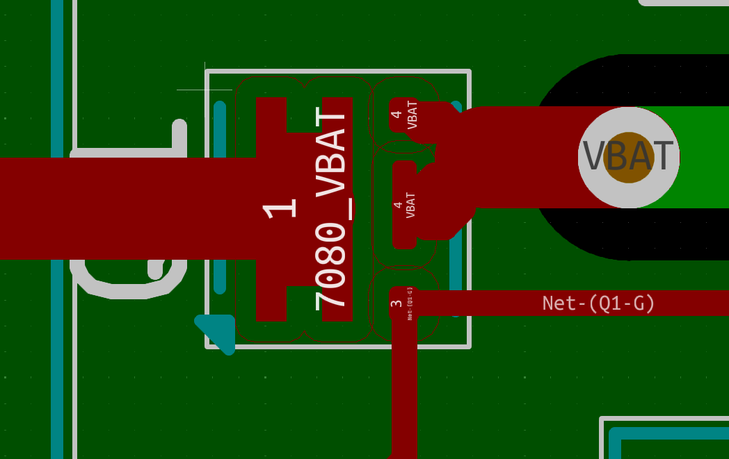

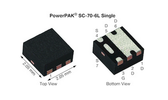

Does anybody know why is PowerPAK SC70-6 Source terminal connection is a little weird? Why is it split into two parts?
How should I route it / them?
Thanks in advance.
  • For heat dissipation.
  • Be careful you that don’t connect the Drain and Source under the chip.
I understand that regarding the drain terminal, which is much bigger area than the two source terminals combined. But the Source, especially the small separated PIN 4? I don't think so.

Strangely enough the copper zone does not properly fill:
This is my best shot so far.
Not great, not terrible. :smiley:
Something looks inverted to me between the package diagram and the footprint. Is red the upper copper layer and is that a 'top' view of the package?
Thanks for checking, but the package is in bottom view.
I see it now. That perspective drawing makes an interesting optical illusion. I thought it was a "see through" top view when I first saw it. That could have unpleasant consequences if you're designing a footprint.
I agree, it's a bit tricky.

I think the cleanest way to do this Kicad is create a small zone around the pads, with clearance set to 0. Hopefully that creates a solid fill and keeps DRC happy.
