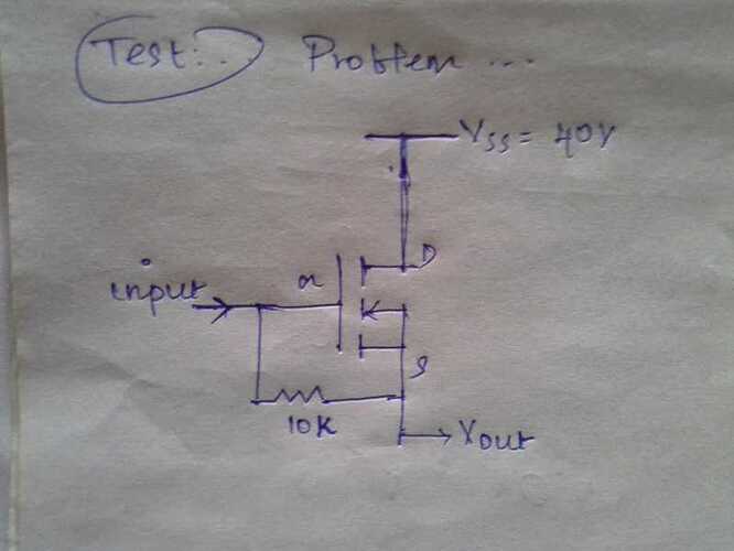

I have a mosfet (irf3205), i want to switch [40 volt] positive supply using it. I can able to switch [40 volt] negative supply. How can able to switch positive supply using n channel mosfet. I have attached a circuit , but its not working. Can anyone guide me, advance thanks.
try googling high side switching N-CH MOSFET
or
googling high side switching driver N-CH MOSFET
You may need a high side driver IC to do the job.
Tom... :slight_smile:
Thanks tom. But I want to switch using transistor, I have a doubt. If want to switch (40 to 50 volt) high side with n channel , what would be the gate voltage of the MOSFET. Is 20 volt in gate is enough to switch.

That is what a High Side Driver is going to do, you don't need the full 20V gate, that is an Absolute Maximum rating.
A P-ch MOSFET would make things easier.
If you want to use a BJT then you need to use a PNP transistor.

You need +60volt on the gate of this n-channel mosfet to switch +50volt high-side.
A voltage difference of +10volt between gate and source.
Because you have drawn an n-channel source follower.
N-channel fets can only be used high-side with a suitable mosfet driver chip.

Leo, i thought that gate voltage of n mosfet should not exceed 24 volt. But as per your suggestion if i give a 50 volt for a gate to switch 40 volt , the mosfet can handle such large volt on gate??
Voltage between gate and source must not exceed +/- 20volt.
Gate must be 10volt higher than source for this n-channel mosfet to fully conduct.
And equal or less than the source to stop conducting.
Drain must be higher than source, otherwise the body diode will conduct.

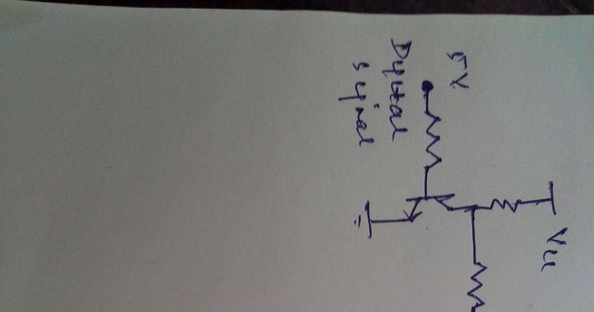

Thanks guys for your replies, i am learning about to switch most faster (with every possibility).

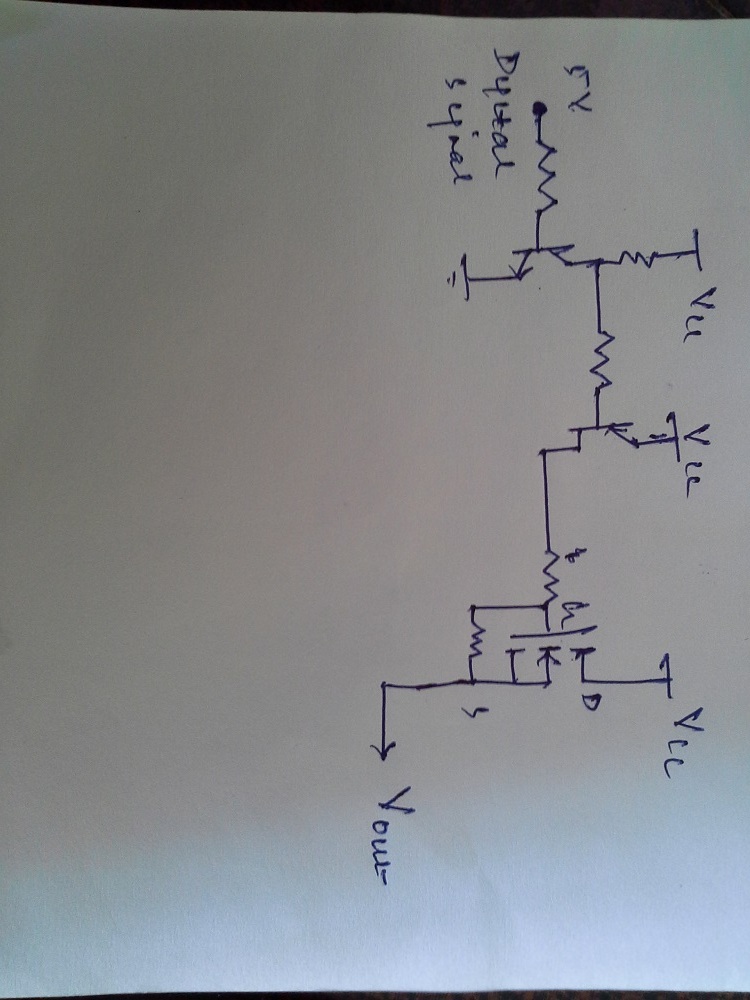

I attached my circuit for high side switch. How to switch the mosfet faster.
Mosfet= irf3205
transistor npn and pnp = mje3055/2955
Ops pic.
Tom.. :slight_smile:
The problem with your circuit is that for the MOSFET to switch ON, you must have a positive gate to source voltage.
When you apply signal to your circuit, your MOSFET will turn ON
But as the voltage across your load approaches Vcc, the gate to source voltage will drop and the MOSFET will not fully conduct.
Hence a balance occurs and you get 12V.

I am learning completely about mosfet switching, in order to make a h bridge circuit.
Can you guide me, how could i fully conduct my mosfet in my circuit.
First what is your Load, what are you switching Vcc to?
This may help with a suitable circuit.
Thanks.. Tom.. :slight_smile:
bldc motor (360watts)
What Tom said.
You are drawing a source follower.
Source is always Vgs(th) lower than the gate.
For the source to reach the same level as the drain (VCC), you must have at least VCC+Vgs(th) at the gate.
More (10volt) if you want to draw significant current from the source.
If the "switch" is not fully "closed", then voltage across and current through the mosfet will heat it up quickly.
To use an n-channel fet like this you must use a chip with a bootstrap circuit (to kick gate drive voltage above VCC).
Leo..
