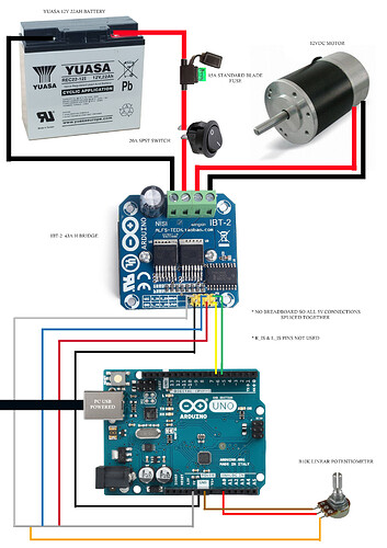

I'm hoping someone on here can help me. I'm having real trouble getting an IBT-2 (BTS7960) H bridge driver working. I'm trying to control a 12VDC motor with a 43A IBT-2 (BTS7960) H bridge using PWM from an Arduino Uno and 10K potentiometer input. However, the motor doesn't respond - regardless of the code I use. All I get is a quiet ringing sound from the motor as I turn the pot, but it doesn't move.
The basic setup of my circuit is as follows:
IBT-2 H bridge is connected to a 12v motor and powered via a 12v SLA battery with a 15A fuse inline and SPST switch.
Arduino Uno is connected to 10K potentiometer and is using the USB power supply.
For the H bridge and Arduino connections I'm using the same setup as described below in usage one:
I'm using the exact code found here. Connections are the same as usage one above. For ease of reference, I've added this code below:

Showing your power supplies and component labels.
A picture of your project so we can see your component layout will also help.
Thanks.. Tom.. :slight_smile:
Hi Tom,
Attached is a layout of my circuit, I'll take some photos and post those too.
Many thanks
Michael
OPs diagram
The info link,
http://www.hessmer.org/blog/2013/12/28/ibt-2-h-bridge-with-arduino/
Shows the neg of the motor supply battery connected to the gnd of the arduino.
Tom... :slight_smile:

Looks like the board has a bunch more connections possible. Are any of them supposed to be connected to enable motor movement?
Paul
