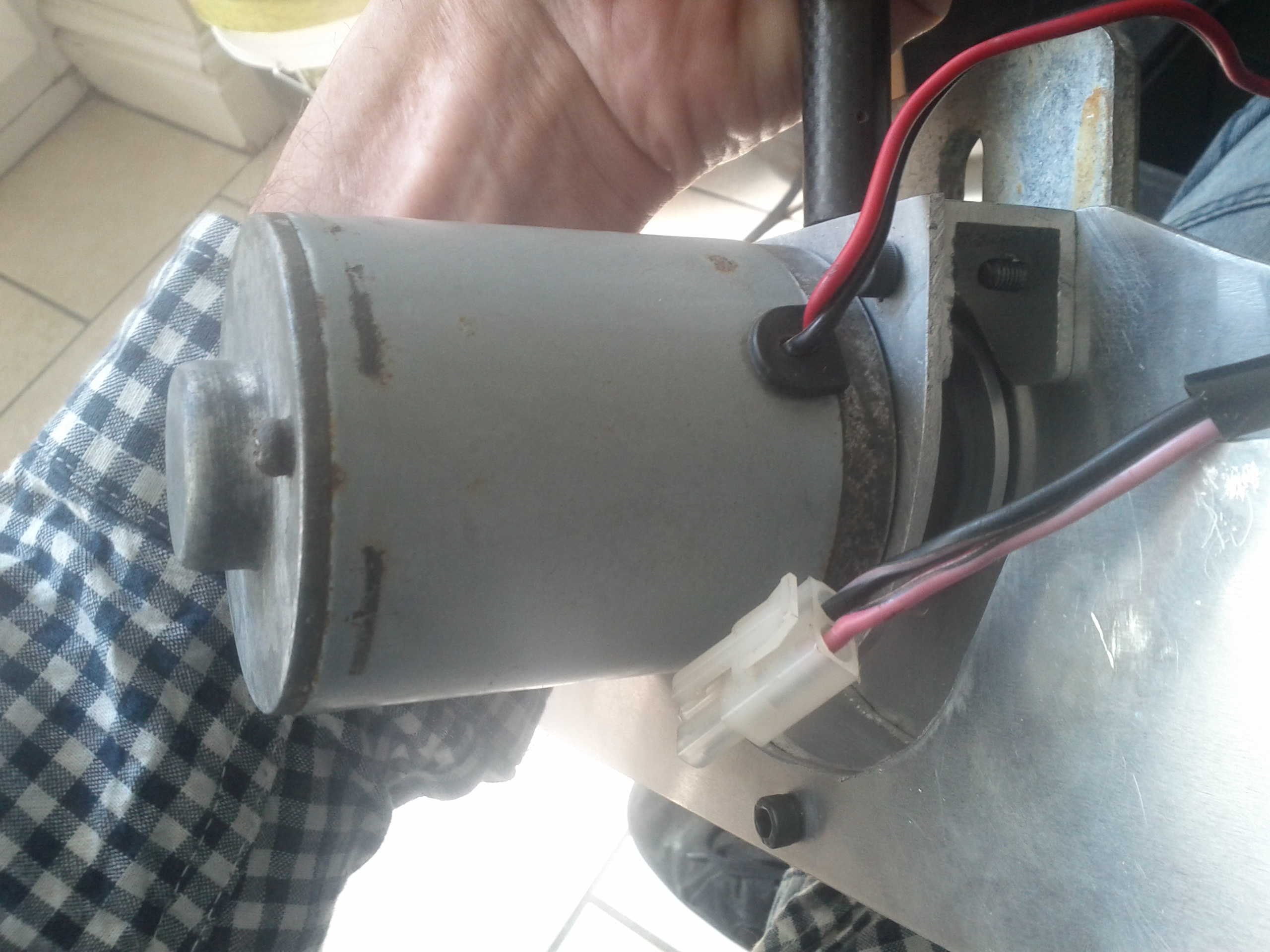

Im mid creating a cable cam with rc unit. I have engineered a great bit of hardware and found some good arduino code and had my new unit running up the line but I have a problem or two and any help will be greatly recieved. Once the unit is up and running Ill happily share the combined knowledge for all.
Im using a 12v/24v dc motor ( taken from a kids electric scooter) not sure what amps whatts it uses but ran from 2x12v batteries.
I have an ardunino uno withr an nrf24l01-rf unit for RX and L928n driver board for the motor.
I have an arduino nano with an nrf24l01-rf unit for TX with thumbstick joystick for controle.
Problems
1 when I run the motor direct with a 3s lipo (12v) battery the motor goes down the 11mm line perfect but when its run via the arduino setup it has very little power and will only go down a 5mm line.
So i thought to increase the volt in (as the L928n takes upto 36v) I tried 18v in but a pop n spark and the l928n is dead any ideas? How would I get more volts in?
2 When it was working the code I used is for 2 motors and 2 tumbsticks to control. I only use 1 motor and 1 thumbstick, I can get the motor going one way when i push forward (with varying speed which is perfect) but when I pull the stick back the motor doesn't work in reverse. This is needed to get the camera rig back along the line. I have attached the rx n tx code I use as txt file if any one could look and see and help or even make it better Ill be eternally great full. My coding aint the best.
So long of the short how do I put more v through the L928n driver board without blowing it and how do I get my motor to go backwards thanks.
Thanks Simon

Please post your two sketches correctly, using code tags. This is all explained carefully in
the sticky threads about how to post here.
You'll have to explain clearly what you are doing, I can't make much sense of it.
One thing I can say is that an L298 is completely hopeless for driving a big motor like that,
it cannot handle the stall current even remotely, you were overdriving it completely.
Characterize your motor beter (measure the winding resistance, post a photo of any nameplate it
may have, or at least a photo of it with rough dimensions). I suspect it wants something more like
10A continuous 40A peak driver. Its probably in the 100 to 200W range.
As for the mechanics I suspect you have no idea if the motor / gearing is over or under powered,
so you might want to share some info on that too.

thanks iv'e put code up correct hopefully but i have not got much data on motor i've attached a pic of it and the l298n motor board.
Sorry if i not explain to well it always sounds ok in ya head.#
I wanted to know how to get more power to the L298n board without blowing it as I think if i get more power to board it will provide more torque to the motor as I need it ti go down a 11mm line / rope.
I also wanted to know why the motor wont go backwards I think its a problem in the rx code?
Thanks
You can't, you are grossly exceeding its maximum current rating with a traction motor like that.
