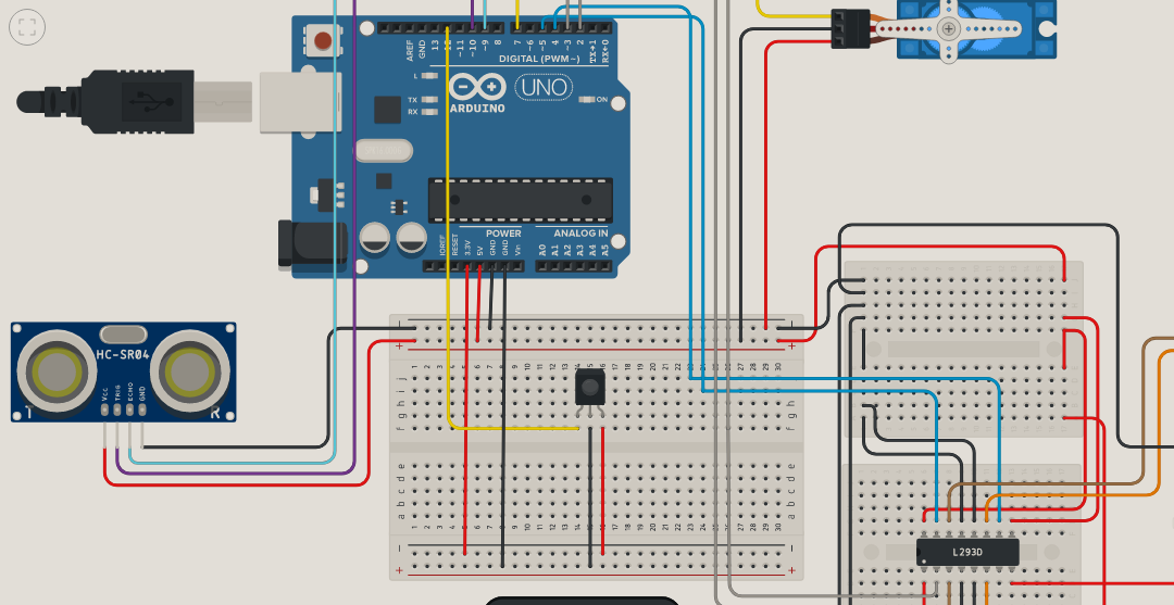

So, I tried making an Arduino Project(Controlling Motors by Remote and Ultrasonic Sensor would activate Servo when the distance is less than 50cm)
I am trying to build a project, A remote controlled car, which will pick up objects when it encouters an object within 50cm. The remote controlled car works fine, but, to pick up objects i am trying to make it work with ultrasonic sensor, but to no avail
First when I just build the circuit for Remote Controled Motors the circuit worked fine, but after adding an Ultrasonic Sensor and Servo the circuit is not working)

The signal from the Ultrasonic module is based on time, and one of the most used ways to measure time is through a timer, it is likely that the use of a timer is interfering.
Your code uses pulseIn() this may be inserting a very long repetition interval of the loop() routine
What EXACTLY does "is not working" mean? Does it compile? Does it do anything at all when you use the remote or place something in front of the sensor?
What do you see on your Serial.prints, does it get to the bits of code you expect it to?
BTW what's with the "if distance < 50 then print the distance is less than 5" ?
Steve
Have you written some code that JUST uses the Ultrasonics?
If not, then do it and get it working.
Have you written some code that JUST controls the servo?
Then combine the two and get it working.
THEN combine your code with the motor control code, which I hope works on its own with the IR.
Tom... :slight_smile:
