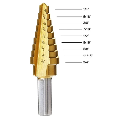

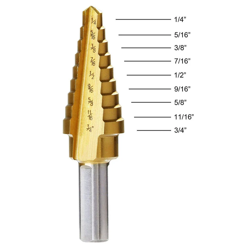

Avoid twist drills when making holes in plastic !
A
step bit
works well, a
D
bit works well too.
IMG_3808
800×800 29.5 KB
800×600 147 KB
Slow drill speed
is needed, let the bit do the work.
