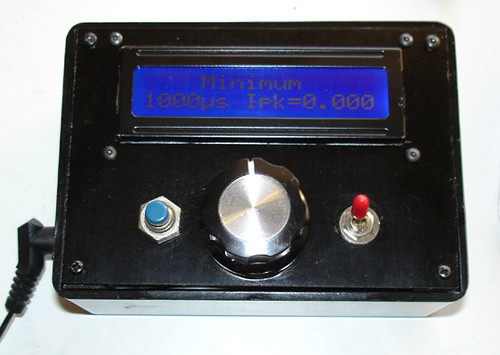

I think we may be too busy building stuff to document what we finish. Here is one of my first Arduino projects, a device for testing radio control servos. It was a tight squeeze getting everything in.
The box was one that had been sitting in my junk drawer for years but 'Project Box 1' from Futurlec is the same size and a good fit for the Arduino. http://www.futurlec.com/ProjectBoxes.shtml
The Arduino is under the home made shield

Did you just use two of the holes in the main board? What size standoffs did you use? Did the box have matching places to screw into?
Sorry for the delayed response, didn't see yr post
Did you just use two of the holes in the main board? I used all three holes
What size standoffs did you use? three small squares of 1/8 inch thick plastic with holes drilled for the mounting bolts
Did the box have matching places to screw into? The box was drilled to match the holes in the board and countersunk so the bolts are flush.

That looks really really cool.
Now it makes sense.
Drill and countersink, that is a good idea.
Thanks, for the picture!
