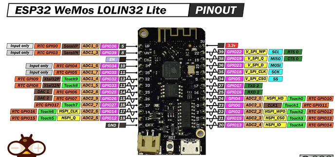

The DHT22 is not showing any readings at all, I’ve double checked my soldering and my wiring paths by eye and with a multimeter and everything looks fine.
The only difference between my breadboard model and my soldered model is that I have changed from using GPIO17 to GPIO25 for the DHT22 and changed the sketch to suit.
Can anybody see any reason that using pin 25 would cause a problem?

did you try wiring it to pin 17 again? I don't know the Wemos Lolin ESP32 lite, may be pin 25 has some other usage
This is the signal signatures of ESP32 Wemos Lolin Lite Board. The DPin-25 should work as a GPIO without any reservation.
Figure-1:
The first thing I am going to try is changing to pin 17 as this will require less desoldering.
If that doesn't work I'll try another DHT22, I've got a few. This time though I'll check it in my prototype.

It's working. Changed from pin 25 back to 17 and amended the sketch and everything works fine.
