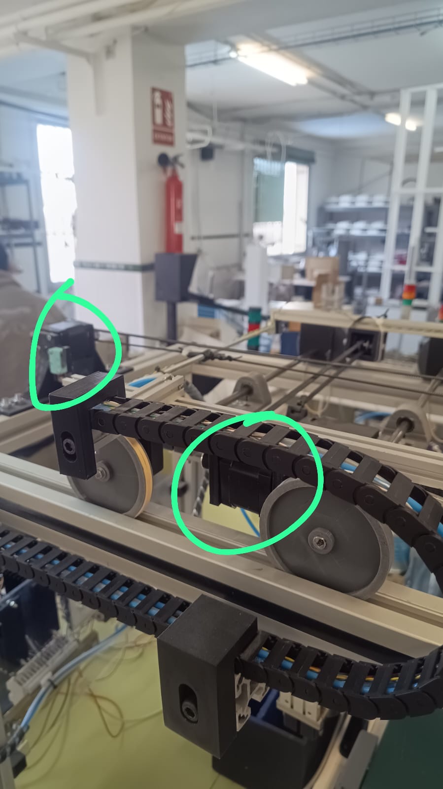

Right now I just want the motors to move slowly. They have attached a device that is intended to move on the X and Z axis with some straps. This device is the one that makes contact with the limit switches.

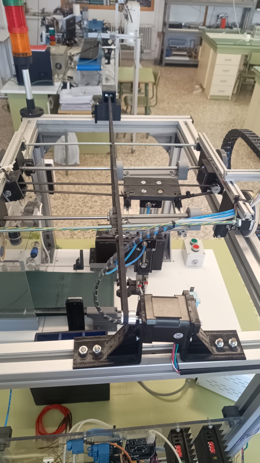

Hey!! Sorry not to respond in a while, but I'm also having a lot of other exams and subjects, so I've been working around in other projects. So, I'm uploading the images here of this ''machine''. The last time I tried I noticed that both motors where heating up a little, and I also heard like pulses, so my guess is that or they are receiveng a signal to stay still, or maybe the signal is not strong enough, I don't really know...
The devices have kind of a messy wiring, but note that there are more people using this so its kind of impossible to keep it clean.

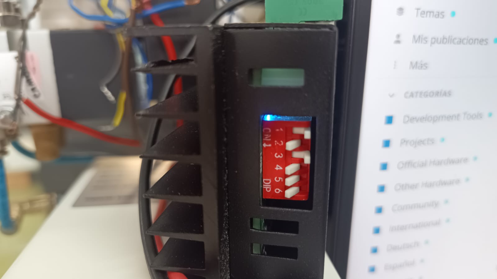

And what are current settings of your drivers dip switch?
Right now i'm using just one motor with a driver, and the settings are this:
And I don't know how to know what is the current rating of the motors...
And we don't know anything about them, expect they have nema23 mount.
Anyway, you have current limited to 0.5A by the dip switches , try with 2.0A, (raise switches 5 and 6).

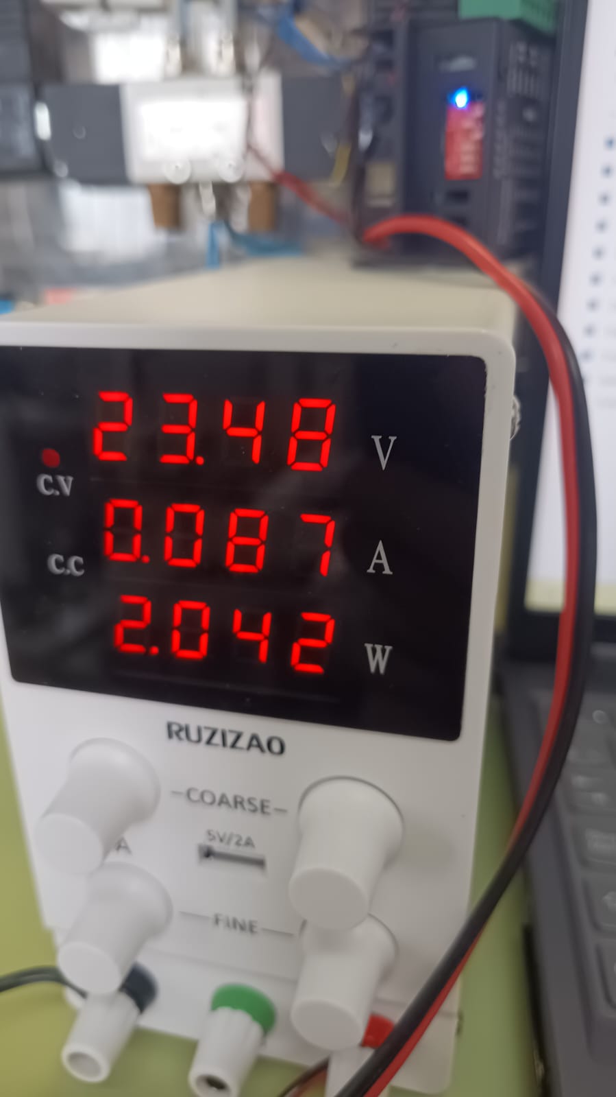

Make sure you don't have current limited by your bench supply.

I also had de 5 and 6 switches raised once and my teacher said that current was not supossed to be so big, that maybe it was a shortcircuit. I really don't know
I only know the nema23 mount. So I can only guess that the nominal current is somewhere between 1.5A and 5A.
But I expect that you know more, normally motors have some name plate.
Also your bench supply needs to be able to supply that current.

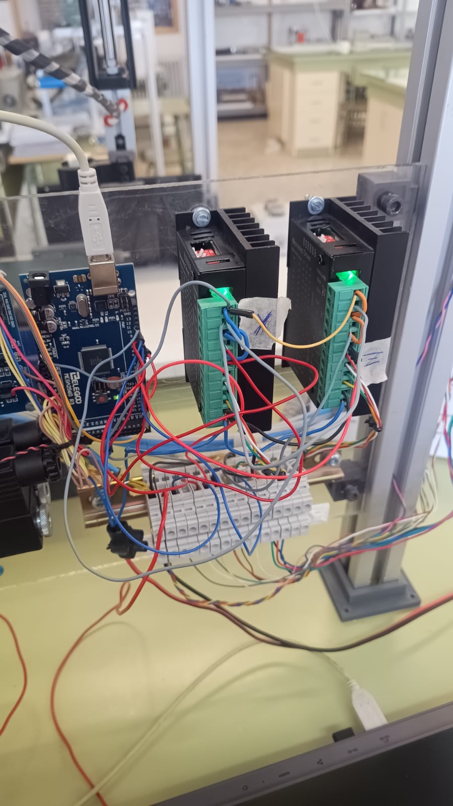

And your wiring has to match the code. Do you have common anode or cathode wiring? Is enable connected?
If you need support here, you need to post all necessary info.
Okay, yes they have nema23 mount, like is said in the name of the post, the bench supply is able to supply that current, i have common anode connection, and enable is connected and set to HIGH in pin 13
Afaik TB6600 is enabled, when enable pin is disconnected. Try that.
So your wiring is like this?
Correct!
So you have inverse logic on everything. To give a pulse you write the pin LOW instead of high.
Common cathode wiring could be less confusing.
