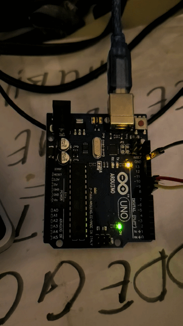

Ok I tried your simple stepper code, same thing. The DIR+ and PUL+ should be connected to pins 9 and 8 and the "-" all to GND right? Cuz the code brings PUL HIGH and then LOW to give the "pulses"
I can see the Arduino works cuz it's led is blinking everytime the commands are sent
Image from Reply #4 so we don't have to download it. See this Simple Image Posting Guide
...R
Sorry to be brutal, but we have all seen flashing LEDs and they are not worth putting in a picture.
Make the drawing that I mentioned in Reply #1 showing how everything is connected when using my stepper code.
