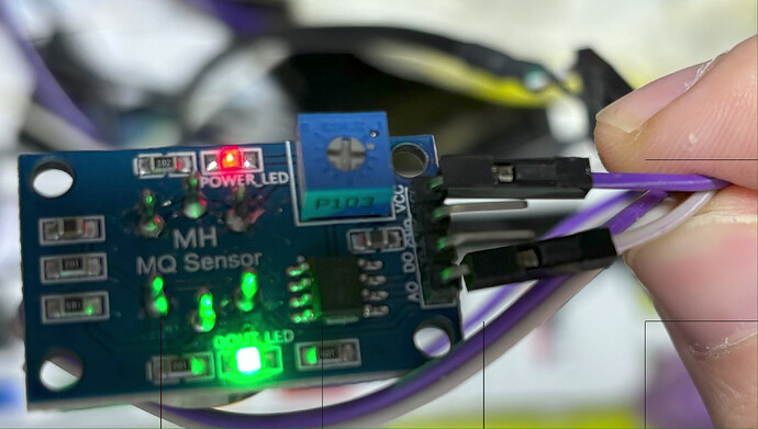

The MQ-4 and MQ-7 sensor module(breakout board) are as the image shows:

I connect the VCC terminal to 5V power source, AO(analog output) to a voltage divider upper resistor, and leave GND terminal floating.
VCC - 5V
AO - resistor - ESP32 GPIO pin
(edited: full: AO - voltage divider upper resistor - ESP32 GPIO pin - voltage divider lower resistor - GND)
GND - floating
(edited: First discovery from debug setting 1)
I find out that evan GND is not connected they still have the analog outputs from AO.
===(Edited: Another discovery:)===
I double-checked it by removing it from my application and connect it with 5v power adapter only, and connect its VCC to 5V and AO to 0V(GND), finding out it would also power the modules on, as the image shows:
(Edited: these image show that even with module GND terminal floating, the module could still be powered on. Pins are VCC,GND,Digital Out,Analog Out from top to bottom. Purple Wire is power adapter 5V. White wire is power adapter GND)

That is likely to destroy the ESP32 GPIO pin. Why did you do that?

If GND is not connected, you are reading a floating input pin, it could read anything.
So you try to "unpower" the sensor? Don't cut gnd with circuits that have data input/output. They can sink through that data line and misbehave/fry your board.
SO, as the images above show, with or without MCU/ESP32 GPIO pin (please just treat the MCU/ESP32 as not existing), MQ-4 and MQ-7 sensor module have outputs even left its GND floating. The module uses its AO pin as the GND/low potential to make it a circuit.

Gpios are not to complete a circuit.

  1. letting other people know this fact exists, and the modules are wrongly designed products. I think it should be designed in a way that the module should not be powered on when module VCC is not connected to 5V and module GND is not connected to GND. But the fact is the module could use its AO terminal as GND to make it a circuit to power on itself.

Here is the internal diagram of MQ-2 module (not MQ-4 or MQ-7).
Reference for those in interest.
If the MQ-2 module diagram applies to MQ-4 module and MQ-7 module, then the poor isolation is due to this route:
A circuit is made even when the GND is floating.
MQ-7 module schematic diagram:
mq-sensor-schematic
The "poor isolation" is a made-up term covering your lack of understanding of the actual circuit function, and failure to connect the grounds, not a design fault or problem.

It's very common design. It is just wrong practice to cut Gnd from sensors or any circuit that has data input/outputs.
If you want to experiment with this argument even more, take a 4-wire pwm controlled cooling fan, wire it to your board, make it run and remove gnd. Tadaa, it keeps on running... Sinking unknown current at unknown voltage to pwm gpio pin that has been configured as output. Even worst from MCU point of view.
