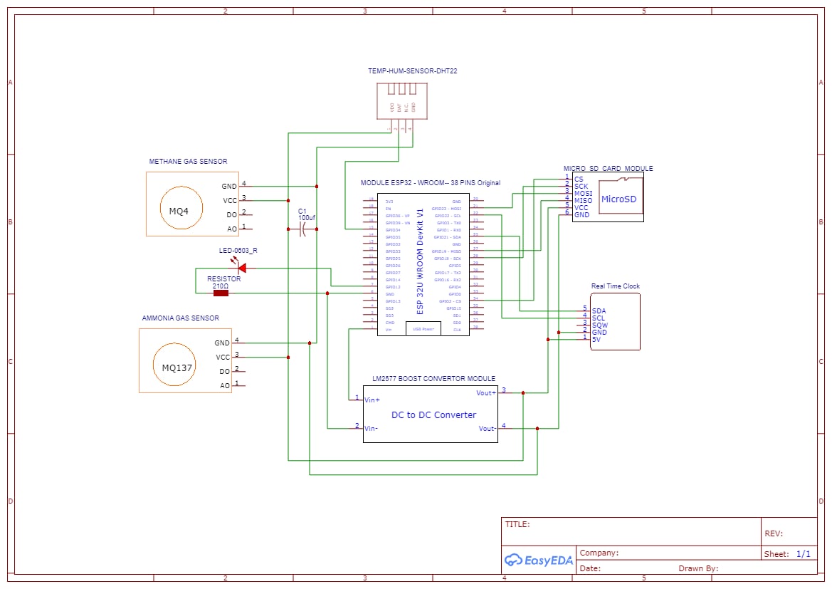

I’m working on a project to detect methane gas using an MQ-4 sensor and MQ-137 with an ESP32. I have an issue with reading the analog output. We don't have access to calibrate it using methane gas so we are testing it with alcohol, butane, and spoiled food.

Steps Taken:
  • Pre heated mq4 for 24 hrs
  • Verified wiring and connections.
  • We are using a voltage regulator and the sensors voltage are 4.95 and 100 uF. It works on 5v +-1
  • Calibrated the sensor in clean air.
  • Tested with alcohol for confirmation.
Observations:
  • Sensor reads 0 in clean air but it is unstable. There is a sudden spike and it drops down to 0.
  • Once we tested it with a gas the analog read takes time to drop down to 0 even after removing the gas.
I already tested it using the code and formula for a simple calibration but there is an issue with stability. But i want to step back and make sure that my analog read sensor will read and stabilize to 0 on clean air. I already tested mq4 twice and this is the third one. I would buy again just to make sure.

Hi, @shiva10
Welcome to the forum.
What is your Vin voltage and where is it coming from?
I cannot see your power supply for the DC-DC converter.
Tom.. :smiley: :+1: :coffee:

I edited and updated the code. I use ppm because I want to detect methane in spoiled food. We have this container setup that has the sensors inside. We put the spoiled food inside and we waited for 1-2 hrs and it has not produced any methane at all. But when we tested the sensor for butane and alcohol it works just fine. There is an unstable reading with or without food:

We use the 5v pin of the esp32. The voltage regulator is set to 5v as well. But it is being divided across the sensors. So the voltage the sensors receive for mq4 is 4.95v.
We use this to power the esp32. We use a battery 18650, 3000 mah
power supply we use
battery

Where in your schematic is the power supply and battery?
Does it apply to your project? Why are you detecting methane off spoiled food? The future application of your project, if any would determine whether or not you want to know if your spoiled food is creating an indoor explosive atmosphere.
Isn't ESP32 a 3.3V ADC? I could be wrong, maybe your boards are different from my ESP32. Did you read this?
