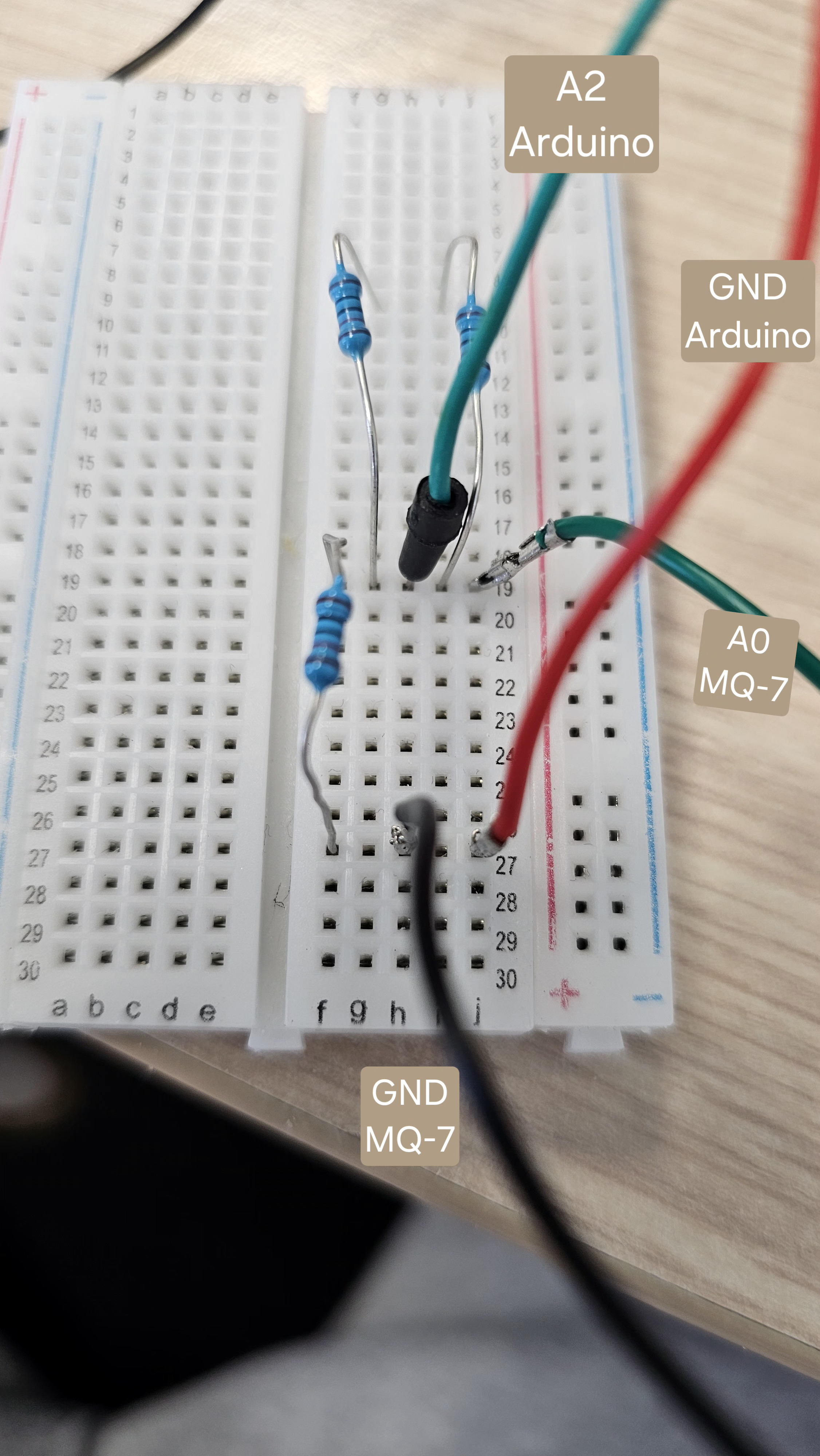

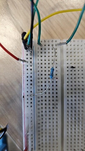

Hello,
I have an mq-7 connected to my Arduino GIGA R1 WiFi and a 10K resistor. I don't know where to connect my resistor because if I connect it between GND and A0, the green LED is off but I have “correct” values but when I connect it between VCC and A0, the green LED is on but the values become “incoherent ” and after checking around, I learned that the green LED must be on to detect CO. I've included my code below, along with images of my connections.
Thanks in advance for your help

Images of the resistor connected between GND and A0
Images of the resistor connected between VCC and A0
Images without resistor connected
If the purpose of your wiring was to drop the sensor output to 3.3V, you need two resistors to make voltage divider.
You can use other values but R2 needs to be 2x R1.

But if you prefer to make voltage divider and only have 10k resistors, you can put 2 in parallel to make 5k for R1.

Then do what I suggested above,
R2 =10k,
R1= two 10k in parallel.
I'm not very good at embedded systems or electronics in general, is that what you asked me?
The sensor is on but not the green LED.
Thanks
AO from sensor needs to go to the other end of parallel resistors.

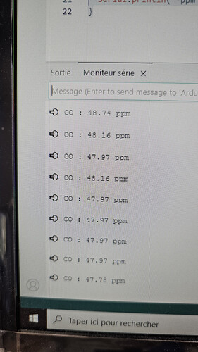

OK, thanks for the clarification, although it doesn't change anything about the green LED. My sensor tells me ~3 ppm but it was the same before I corrected my error... Very strange, isn't it?
Good, because LED indicates a gas level above a set threshold.
Sensor needs some time to heat up. The analog voltage difference at 3ppm is so small that you can't see difference between with/without voltage divider.
Your wiring looks correct now. But please don't use red wire for GND, it's very confusing!

So you want me to keep it like that? Above I sent some screenshots where I had similar values. The idea is that if the CO level is too high, my GSM module sends me an alert SMS. So it's me who defines the limit values for which the GSM sends me a message. So my previous set-up may not be disturbing, given that I have control over the parameters...? The problem is that I can't calibrate my MQ-7 because I don't have a “real” CO sensor to hand.

In this case I think you only need one 10k resistor, between anologue out and ground.
The gas sensor has a current output, and a 4k7 resistor (MQ_R2) to convert that (~1mA?) current to a voltage. A 4k7 + 10k sense resistor (parallel) there drops output voltage to 2/3 of it's original voltage.
A 2*10k voltage divider (4k7+20k load) would drop it to ~1.9volt.
