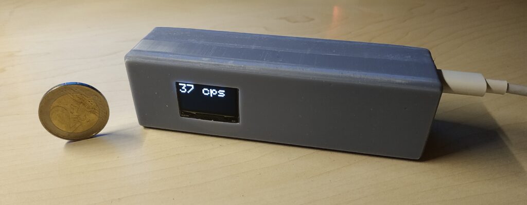

Hey there,
I built a so-called "scintillation counter" with an Arduino UNO. It's a much more powerful and sensitive device than a conventional Geiger counter for detecting gamma radiation. It uses a scintillator crystal to convert the gamma-rays to visible light, a silicon photomultiplier (SiPM) to convert the light into current pulses and the Mini SiD board, a front-end signal processing board for SiPMs. The digital signal going from the Mini SiD is then fed into a digital pin on the Raspberry Pi Pico. The Pico essentially counts the pulses produced by the gamma radiation and outputs them to the Serial interface for later processing. There is also a sketch to use with an SSD1306 OLED.
As you can see, the count rate with this small 10 x 2.5 cm board is typically at around 25 counts per second (just natural background) with my setup here, whereas you typically display in counts per minute with Geiger counters.
