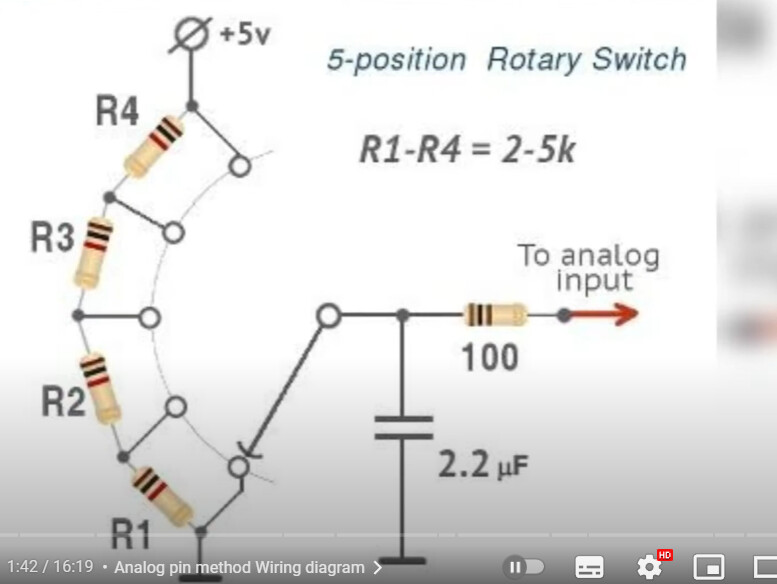

Iam trying to use the following circuit to convert 7 position switch to analog input.
I follow as per the picture using 2K resistor in place
the output I get is
position - analog value
0 - 0
1 - 700
2 - 1580
3 - 2446
4 - 3500
5 - 4095
6 - 4095
7 - 4095
the issue is I get 6 and 7 as 4095 only.
So kindly help to choose the resistor value or any other mistake I did.
i am using esp32
voltage across switch is 5V
regards
Santhosh

Use 3.3 volt across the switch. Else You might damage the analog input or more.
Railroader is right on. It is very possibly you have already damaged your processor. When using processors you need to be aware of there limitations, this you get from looking at the specifications etc. Had you spent some time reading the forum you would have found this. Also many adds selling them state that. A big hint very few if any processors have internal A/Ds will take a voltage greater then there Vcc. I recommend you remove your 5V connection and re-connect to a 3V3 volt connection and see what happens.
