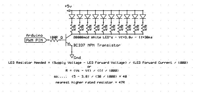

Hi all,
I’ve been googlin’ like mad to try and work out a way of running a string of parallel leds off of one arduino pin.
After mucking about with transistors I think what I needed was a FET. I wanted to run 10 leds of the one pin and came up with the circuit attached (hopefully self explanatory) but to be honest I really just had a look at other similar circuits hence the 100R resistor and 10K to ground. I put these in as I have seen them on many other similar circuits but don’t understand fully why (apart from limiting the output current of the arduino pin). I figured after a while (and some ebaying!!!) to hook this up and see if i got my desired result and it seems to work with the standard fade example, but was wondering if anyone had any reason why I shouldn’t do this, i.e blowing up my arduino, damaging pin etc.
Circuit attached and data sheet for the FET used.
BS170 N Channel FET rated at 500ma - www.fairchildsemi.com/ds/BS/BS170.pdf
Thanks for your time.
Looks great to me. Gonna be very bright - wear shades!
100R limits current out of arduino into the Gate capacitance of the MOSFET. (Uncharged cap looks like a short circuit.) 10K keeps the MOSFET off while the Arduino resets and all IO pins are inputs, prior to sketch taking over and turning them off or on.

Ok, the Resistors may have to change then. Vf of LEDs varies a lot by color.
I thought I was looking at one of my old posts whenI saw the schematic …
Yep, i’m in the process of calculating the correct resistor values for each of the colours right now. Thanks again for your help an of course one more quick question (lol there’s always more questions right!!), can I swap the resistors to the Cathode side of the led’s (would help when etching up my pcb -no jumpers etc). I’ve read that it does not matter which side of the led the resistor goes but was unsure in this case if this was ok?
  1. The BS170 isn’t a good choice for the mosfet because it isn’t logic level. Fig 1 on the data sheet http://www.fairchildsemi.com/ds/BS/BS170.pdf suggests that its performance with 4v to 5v gate drive will be marginal. If you only want to switch up to 500mA, you could use a bipolar transistor (not darlington) such as BC337 instead (use a resistor from Arduino pin to transistor base of about 180 ohms, and you don’t need a pulldown resistor). For more than 0.5A, choose a logic level mosfet.
  2. Yes you can put the resistors in series with the cathodes instead of the anodes.
  3. A minor point: I would connect the 10k gate pulldown resistor from Arduino pin to ground, i.e. connect it to the other side of the 100 ohm resistor. That way, it doesn’t reduce the gate voltage drive to the mosfet slightly.
Remember if you are going to use RGB LEDs then you can't put the resistor in the common line.
Hi dc42 and Grumpy_Mike thanks for the info, I will look into the BC337 as I have a few lying around. The RGB’s I have do not have a common anode or cathode, they have 6 pins A & C for all three diodes so I guess i’m good for the resistors as I can treat them as separate leds.
I’ll also adjust where I put the 10K as suggested or of course omit it in the case of using the BC337.

Update: New Circuit should look like this?
Yup, that work too. Electrons don't really care.

The specification of the LEDs on that first link suggests that the maximum continuous forward current is 20mA, and 30mA is the peak rating for short pulses (the second link doesn't give any current ratings). So I suggest you choose the series resistors for 20mA per LED, unless you know that your LEDs are rated at 30mA continuous. The BC337 is likely to drop 0.2v or a bit more and you can allow for this in your calculations. You may find that the red one has a lower voltage drop and needs a higher value resistor.

Figure on calculating current based on the lower voltage drop too, for example with 5V source, 0.5 across a transistor, and 120 ohm resistor:
(5-2.4-.5)/120 = 17.5mA
(5-1.8-0.5)/120 = 22.5mA << so a higher value resistor is needed
Similarly for a 50 ohm resistor:
(5-3.6-.5)/50 = 18mA
(5-3.0-0.5)/50 = 30mA << so a higher value resistor is needed

I'm looking at running around 12 to 14 of these boards using shift registers. Am I gonna need a high current power supply or am I right in thinking that the transistors are doing the work?
Looks like you have a maximum current consumption of 10 x 20mA per colour per board, total 200mA (which is just fine for a BC337 to switch). Times 3 for the colours and you have 600mA total per board. Multiply that by 14 and you get 8.4A. So yes, you will need a high current power supply. One possibility is a standard ATX computer supply.
It would be easier to use higher voltage and lower current. If the LEDs drop 3.2v each, then instead of 10 led/resistor combinations in parallel, you could have 2 sets of (5 leds in series + one resistor). This would drop around 16v, so you would need (say) a 20v supply to drive it, and drop 4v in the series resistor. But it would consume 40mA per colour per board instead of 200mA. That brings the total power requirement to 1.68A at 20v, which is more manageable than 5v 8.4A.
Another option is 5 parallel groups of 2 leds in series, which would need about 9v @ 4.2A. If your boards had 12 leds instead of 10, you would have even more options, i.e. 12x1, 6x2, 3x4, 4x3.

Edit: So been thinking about what dc42 said and rummaging through my box of hoarded power supplies I have found an old laptop power supply rated at 20V 3.25A DC does anybody think this might be ok?
Edit 2: Final circuit being added below! (hopefully!!!!lol)
Add up the volts drop, I think there are too many LEDs. Anything with a current limiting resistor under 50R is pushing it for constant current like behaviour.
